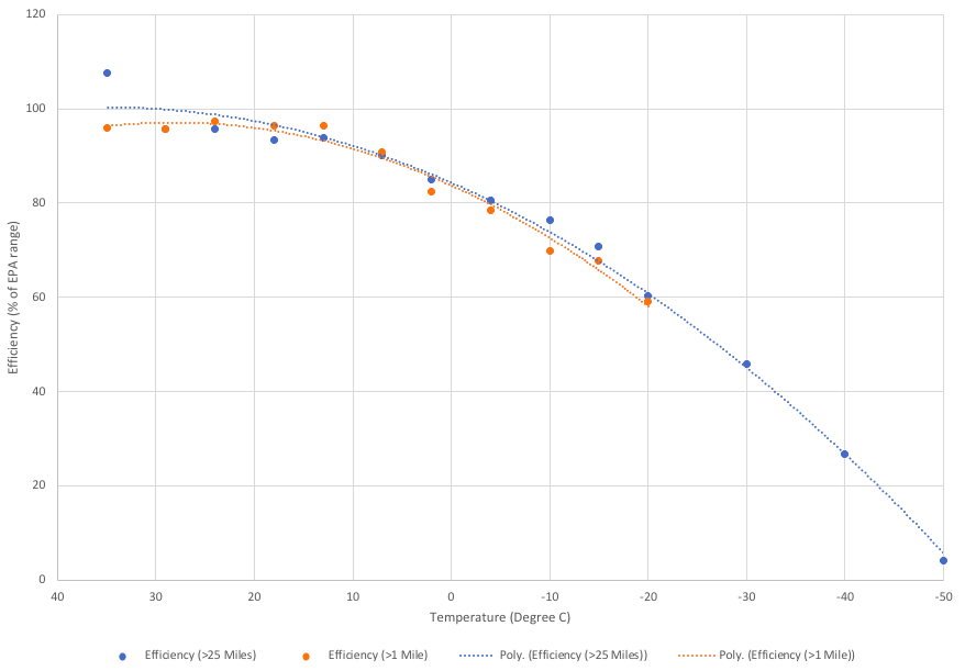

https://teslamotorsclub.com/tmc/threads/33-range-loss-in-cold-winter-conditions.106072/
The last three are hypothetical points based on the curve projected from the actual data.
Cold is a major issue, but at the same time it's an issue that only really comes into it's own when going below 0 C. A 40% range loss isn't uncommon in the cold. How much of a problem it is depends on where you live and where you travel. Going to Baja, not so much, going through the midwest US/Canada during the winter and it is an issue.
There are also issues with towing, far more so than an ICE vehicle - a loss of 40-60% is pretty common for the Model X with a small trailer. It may not be as much of an issue with the RT1 due to the less aerodynamic shape.
BEV's are likely to replace ICE in most application, but like all technologies they are not without their issues and they will not be viable for every application. I'm personally looking forward to a BEV truck with a 6' bed, at a similar price to an ICE truck. It's going to take a while, but the Rivian is certainly a good start.
