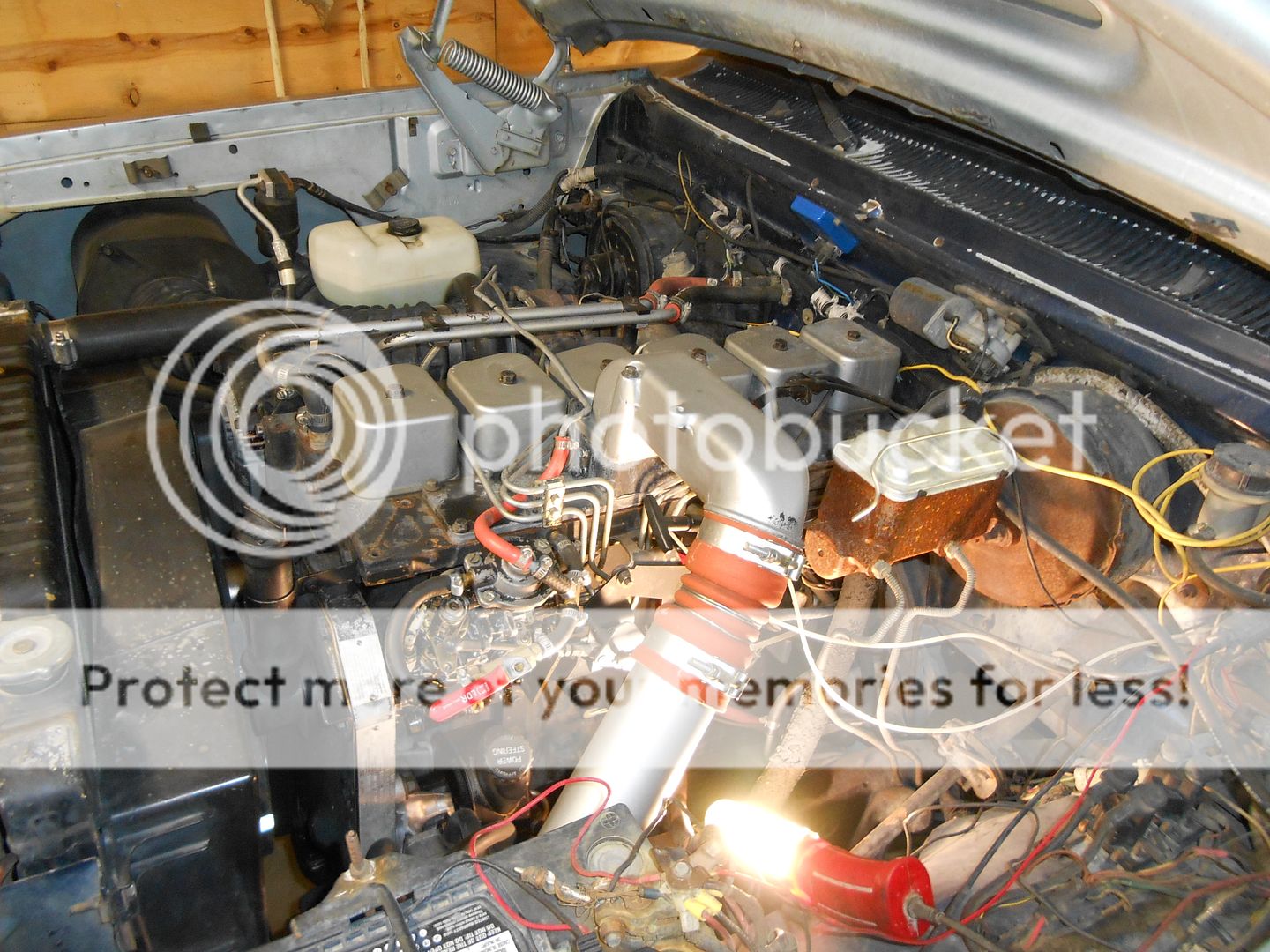

Been a while since I took any pics of this truck so heres a few new ones.
So over the last couple days we've been pretty busy on the 90. repaired the odometer as the it had broke the little gear the motor which is pretty common on these trucks. Then the other night I dug in to reseal the VE and to swap n a different set of injectors and I also replaced the tappet cover gasket and spun a new fuel filter on it. While I was in the Injection pump I swapped in some solid rollers and heavy duty return springs, I also thought about swappin in a different camplate with a different profile but wasn't sure if it would mess with the internal timing advance
The VE fought me the whole way, first off the bottom nut was a huge pain in the butt even with the correct wrench. Then after I had the pump all back together an on the truck I realized I had left a piece of the control valve out and the truck wouldn't idle, so off with the pump again, I replaced the piece I left out and jammed it back on the truck, set the Idle and I think were golden now. It'll be kina nice not leaving a puddle of fuel under the truck when ts cold now. I imagine it should help with economy also.
