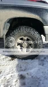

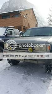

Finally getting some pictures up of the Yellow tint and my new K02 265/75R16
This photos really came out looking like crap. They look fine on my phone.. no idea what is it, must be the transfer from photo to computer then photobucket.

Tires look great! What tint did you use for the lights?
I used some 35% yellow vinyl tint off ebay. Came in a 4ft x 7" wide. Cleaned the lights, sprayed the lens with light soaped water. Dipped the vinyl in water to help fight the sticky side. After I got it centered and a little dry I used my stove to heat the vinyl and stay in place. Took a couple tries to get it right. Not hard at all, already making my money back on the purchase of vinyl by doing friend subaru and other vehicles fog lights.

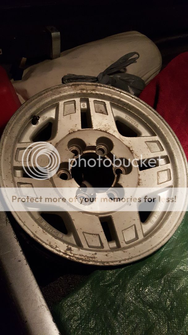

Went by TOYTEC LIFTS today down in NorthGlenn, CO. Awesome builds all over as I walked up. Feeling lie my vehicle was a straight turd. I was wrong, they came out to check the mysterious T100 out and were impressed with low miles and pretty clean. Also picked up some 15x7 wheels in fair condition. I mean at $50, came with all 4 black/red caps and all lug nuts. Now if anybody has 1 of these for sale.. haha
With a little elbow grease and some silver or black paint these new shoes will look great! I'm just excited to fit them with 33x10.50 BFG KO2!
