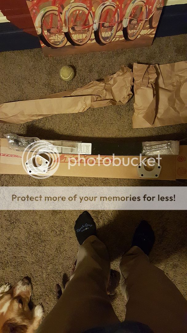

Picked up my ToyTec 2" BJ SPACER/ADD-A-LEAF kit today. Great to see that these are a DEAVER leaf product as well. Scott was awesome for making sure everything was going to work just fine. He was also excited to have T100 there to check spec on rear leafs and other odd ball questions customers may bring up in the future.
toyotech
Just install the Bj spacer and leave the t-bars alone. You will get the same ride as before but be a tad taller. It's what I did on my 4Runner.

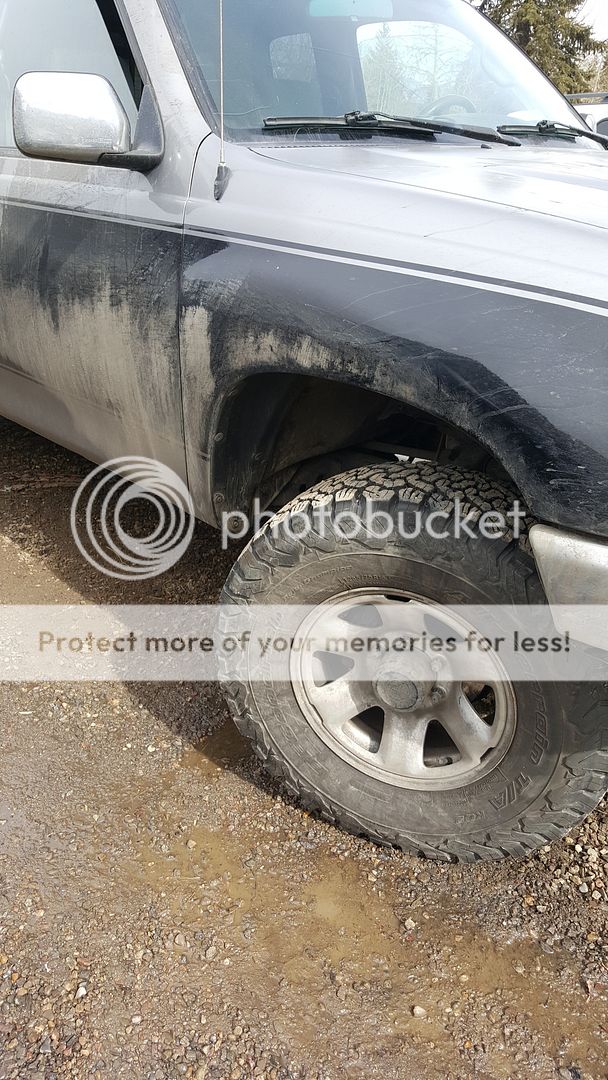

Finally took off my mud flaps front and rear. Really looks way more aggressive!

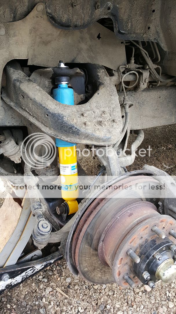

Finally also got my Bilsteins installed on the front and check if the snap ring is doing it's job. Ended up looking fine!

Bilsteins look great on there!
My truck didn't have mudflaps when I bought it but with 245/75's the spray isn't too much of a problem (for me, I dunno about people following me). But eventually if I keep the truck (I'm getting new Tacoma curiosity again) I figure I'll eventually get new tires, 265's, and maybe Bushwhacker flares (the narrower ones. Anyone had experience with these and do they keep the body sides cleaner? BTW I like it without the air dam ...
