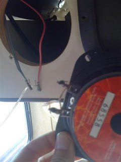

So also, after putting in this new headunit, it puts out 17 watts RMS and the speakers in the van, I found out, are CRAPPY Autozone $5 speakers which can handle PEAK 25watts...yikes, no wonder it sounds awful. I also found some interesting wiring leftover from the previous owner...not sure how he thought this was a good idea. Even MY wiring isn't this bad...
SO - I was really happy with my Pioneer speakers I had in the Jeep (which were ~$60/pair). You can crank them up after taking the bass out (via the equalizer in the headunit) and use them for all the high notes and let the subwoofer handle all the bass notes. This worked great for heading out on the town and bumpin' the party tunes with a carful of people! It even got TOO loud and that was without an amplifier to the speakers.
The plan now is to get some decent Pioneer rear 5.25 speakers (since those are what the Jeep had) and get some Pioneer 4'' speakers for the front stock location. These speakers will come from the Crutchfield outlet and would cost less than $100 for all 4 new speakers.
