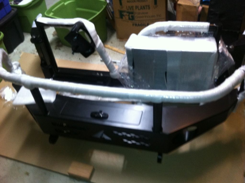

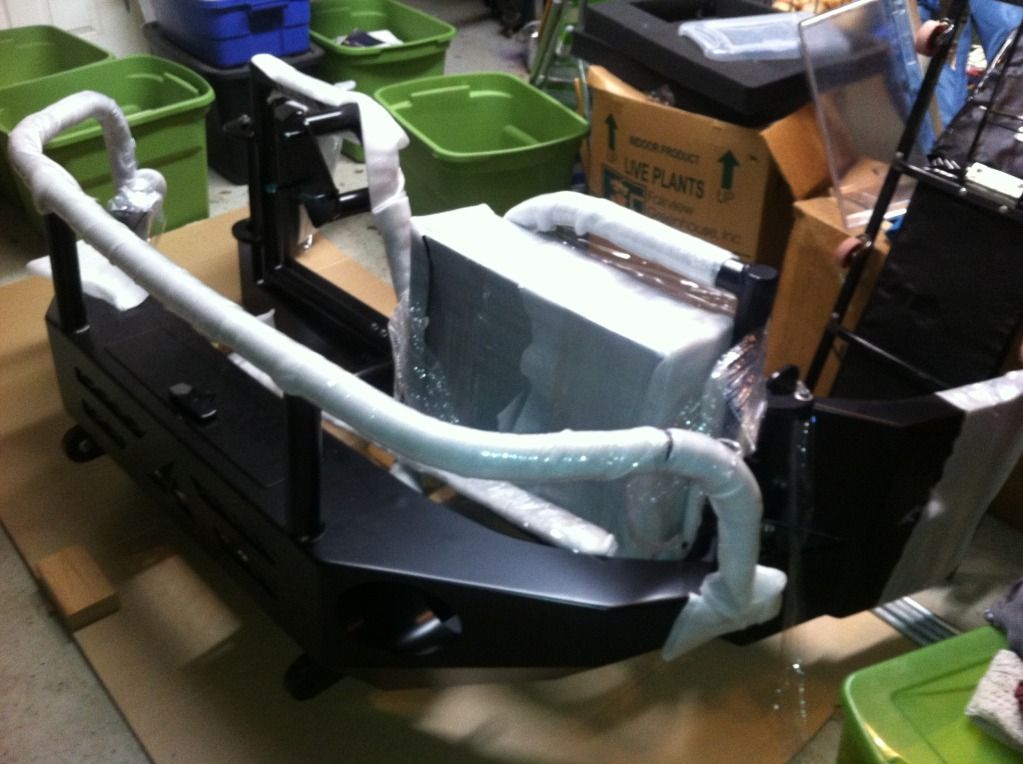

Our Aluminess winch bumper and rear bumper with dual swingaways arrived yesterday. They are fricken' works of art! Can't wait for the weekend.
