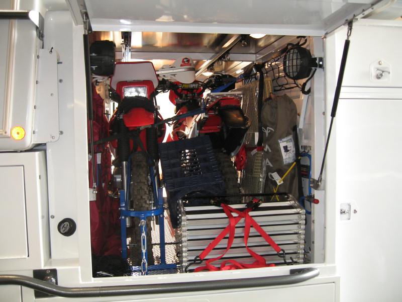

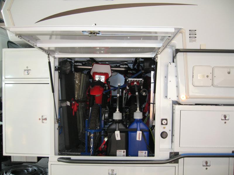

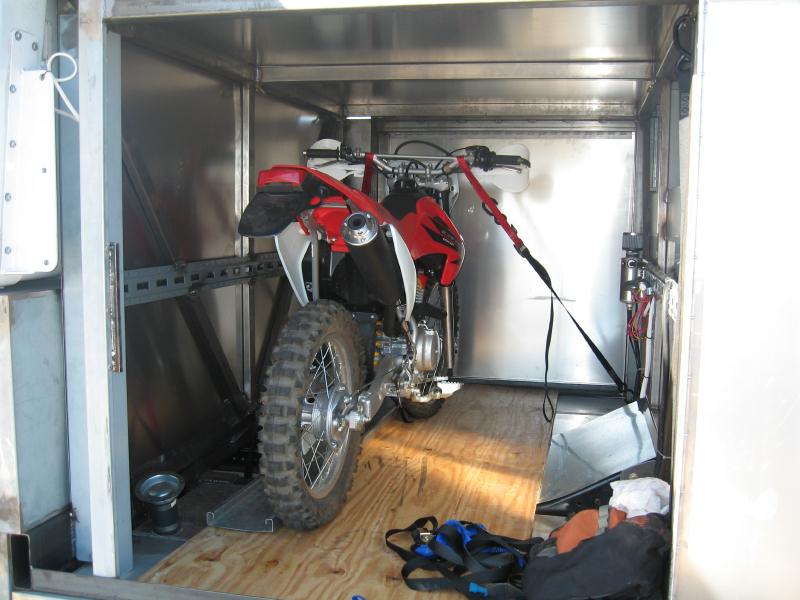

Here is the same idea you have for carrying your motorcycle behind the cab. This is in a Semi.
Yup - more or less.
Without the bike the 'garage' could be used as a 'sleeper' if properly designed.
I was looking at the Hackneys setup and noticed they had access to various systems inside their 'garage'; wiring systems and it looked like batteries, possibly aux. batteries, under the floor. That is something to consider in the design; put some of the 'mechanical' and electrical system stuff off of the 'garage'. Things you wouldn't necessarily need to access all the time, but maybe would like to access in out of the weather.
With the 'robotic' tray loader I linked to above, since the size is 4'x8', you could maybe fit up to three dirt bikes in it, certainly two. That loader only unloads one way and it weighs almost 1K pounds, so that is a major weight addition.
