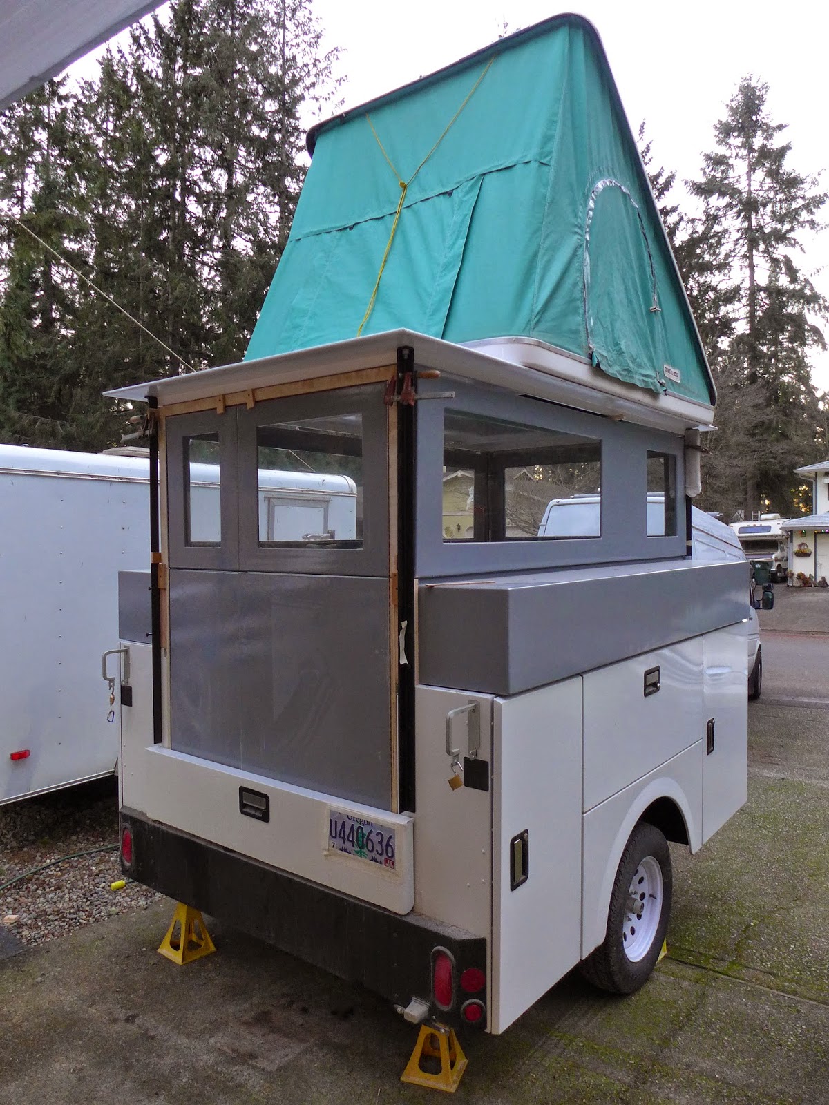

(above) With the help of a friend, the roof top tent support platform was placed on the roof rack... Next the tent pod was placed on the platform...
(above) It's big when the tent is opened up...
(above) Before the rear doors are installed... I like all the glass...
(above) The grey color Mike suggested is a great choice...
(above) Rear doors installed... Alignment is critical and both lower doors were scribed and trimmed to fit...
(above) End of the day and the fitting is of the panels is close to done... Still have latching hardware to install and a hundred other details to work out...Sure is fun...

if the rtt will stay on the rack (not telescope down to trailer level/ top of added toolboxes), what is the purpose of the folding windows & doors?
and in any case, what will keep the whole unit from wind-rocking while in use? will there be outriggers & pads?

I'm sure I missed something along the way .... If the rtt will stay on the rack (not telescope down to trailer level/ top of added toolboxes), what is the purpose of the folding windows & doors? And in any case, what will keep the whole unit from wind-rocking while in use? Will there be outriggers & pads?
There may be actuators added later to lower the tent platform to the pod tops. The design was done so as to facilitate their addition if I choose to go that way. We'll see.
The walls fold down for lowered wind resistance/easier towing and, much more importantly, a very open feeling when camped on a nice day. The independent folding sections allow you to block the wind or sun as needed while leaving the rest open. I will likely also be designing a 360 degree screening system so that the sides can stay dropped when the climate is pleasant but bugs are out.
I don't think any one knows to what extent the trailer will rock due to wind. Probably not as much as it will rock from people moving around in the tent, I wouldn't think. In any event, the trailer will not rest on its suspension; it'll be stabilized at either three or four points (depending on whether it's attached to the vehicle), so there's reason to think it might be OK. If it's not, I'll deal with it later.

from the last picture in post #134, don't the sections fold inward? this is leaving half of the floor space for moving around? if there are screens for all sections dropped, what's left?
or have I completely lost my faculties?
If you look in Post #134, Paul provided a picture that shows the sidewalls flopped to the outside, where they rest on top of the pods. The piano hinge across the base of the sidewalls allows them to fold in either direction.
Anyway, with the sidewalls folded out and the front and back folded up against the ceiling, the 4x8 inside area will be totally open to the outside. Sorry for the delayed explanation.

Notice in this picture:
the piano hinge is attached above the pod by enough that the nominal 3/4" sidewalls have the clearance needed to fold outboard and lie flat on the pods.
