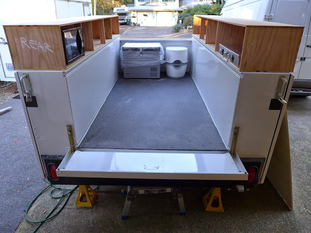

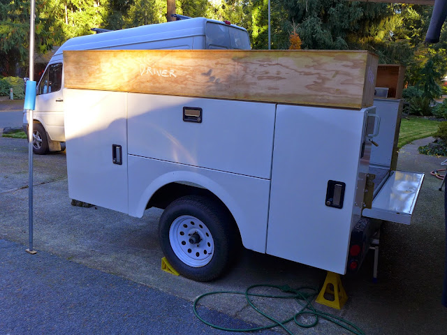

(above) With a couple of other projects done, it's time to focus solely on the trailer... As mentioned above, I picked up from Mike the bulk of the remaining components for the build...In the bed, roughly in place, are the fridge and toilet...I'll be getting to those next week...

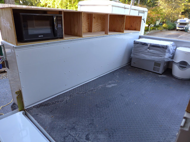

(above) On top of the steel boxes are the 'pods' that will go on top, and be accessed from the inside... The featured item on this side will be the microwave...

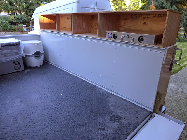

(above) Curbside will have the stove and pull-out sink...
(above) Eventually these will get fiberglassed with epoxy resin and white marine grade paint... The inside will also be built to get wet, with epoxy and glass inside as needed...

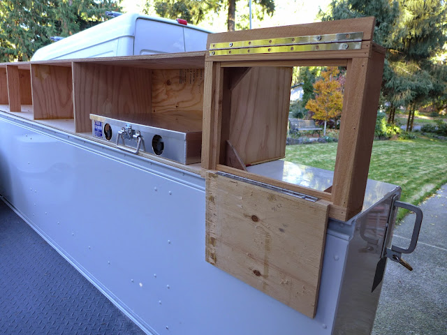

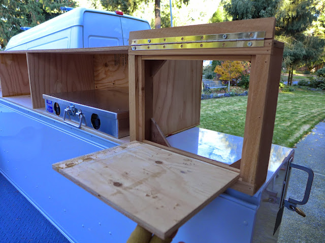

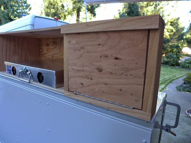

(above) I made a little mock-up of the door/drawer system... See if you can figure it out...
(above) The doors/drawers will have a reasonable amount of weather protection with overlaps and gaskets...

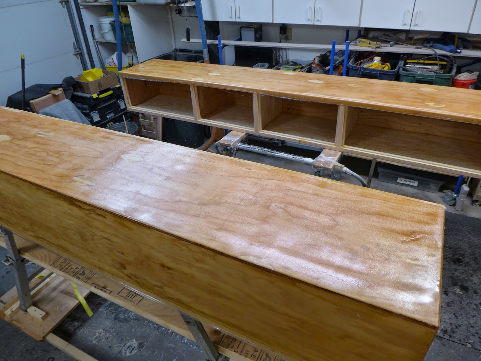

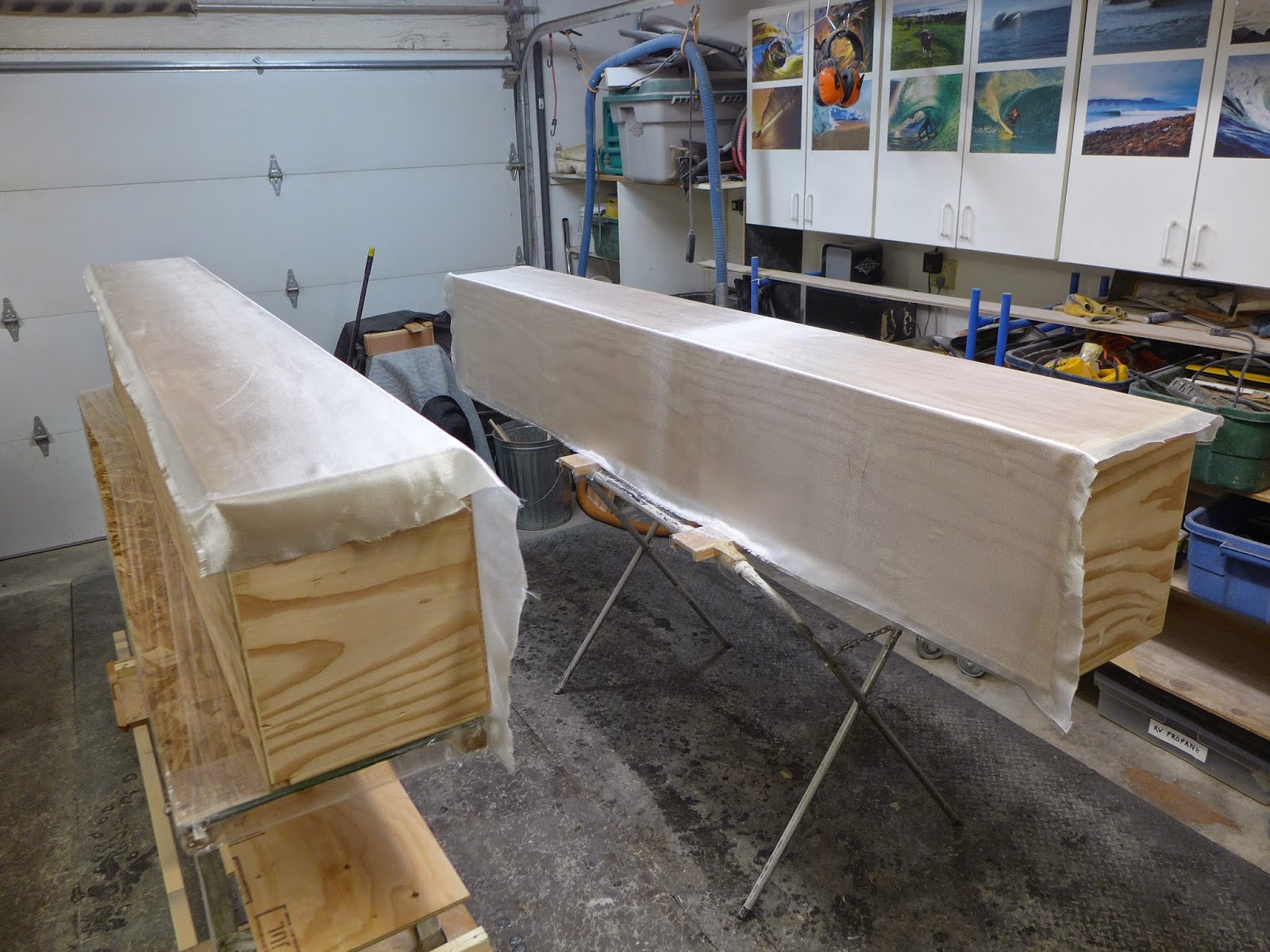

(above) The 'Pod' cases are built, sanded, edge routered and sanded again... After dusting things off, a layer of 4 oz. fiberglass 'e-cloth' is draped awaiting epoxy...
(above) The fiberglass over wood method has me thinking of the work of Anderson Boats in California...Friends have custom work done there, I see lots of pictures of their work and try to follow how they do it... One difference is I use epoxy resin, they use polyester... Epoxy is stronger and more flexible... Less toxic too...

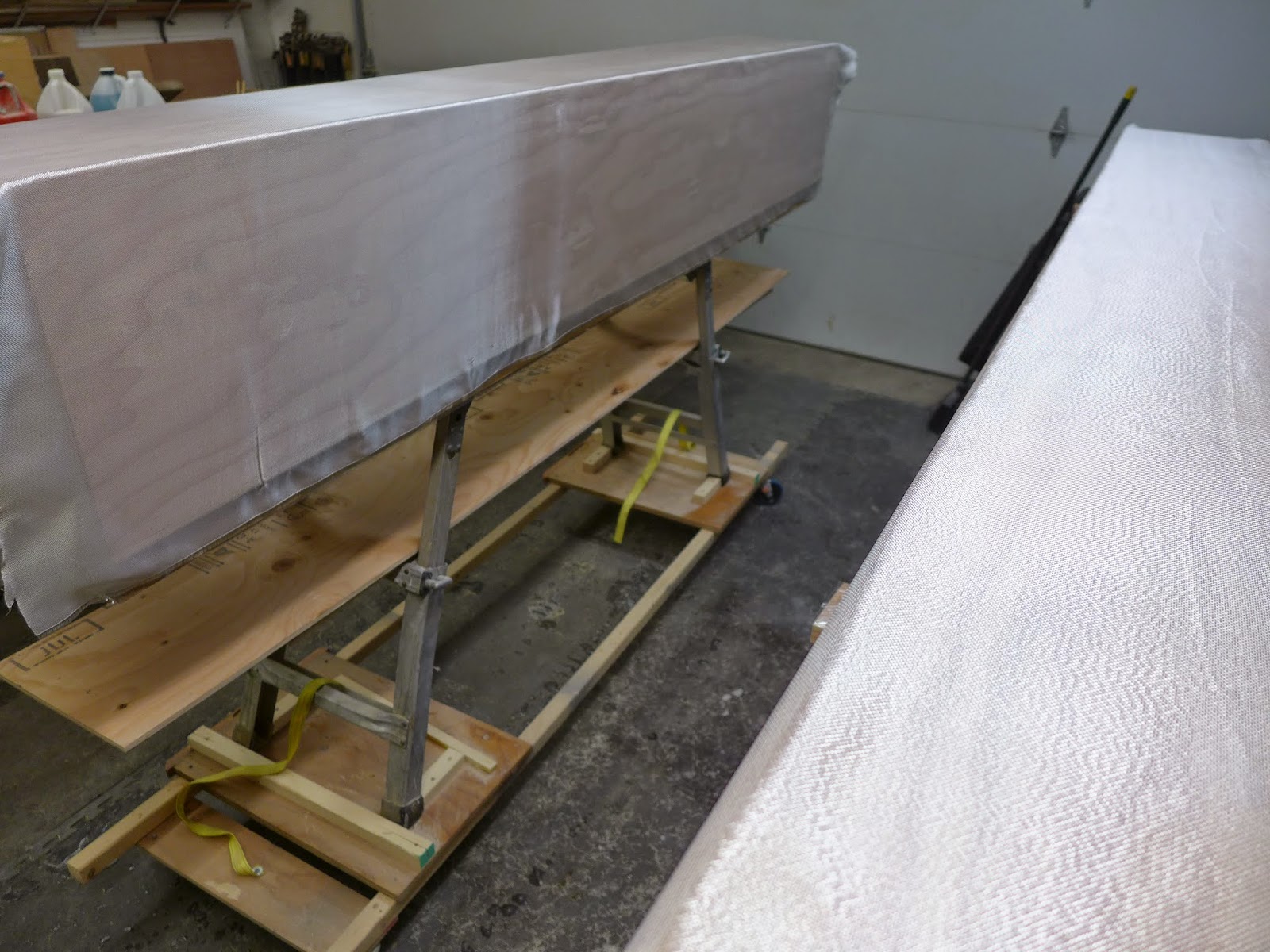

(above) The cloth has been saturated with Resin Research Quick-Kick epoxy resin, squeegeed flat and after a few minutes, the case is rotated to do the other flat side...

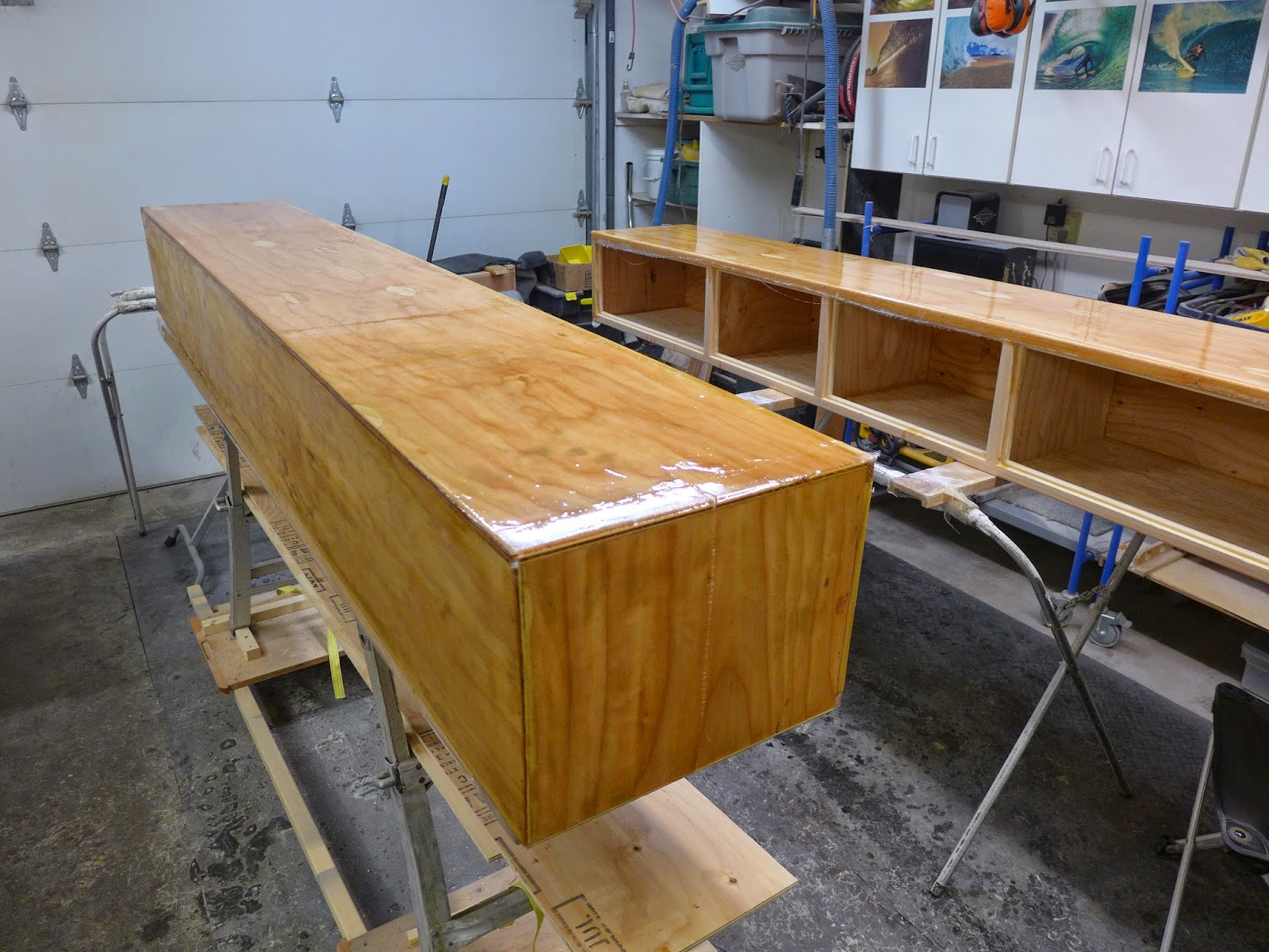

(above) The end panels were covered over, then the top flat surface had a coat of epoxy rolled on to fill the weave of the glass cloth...Later it will get sanded smooth before painting...
Next, the inside and face of the cases get sanded further, then glassed and epoxied...Things are progressing nicely...
