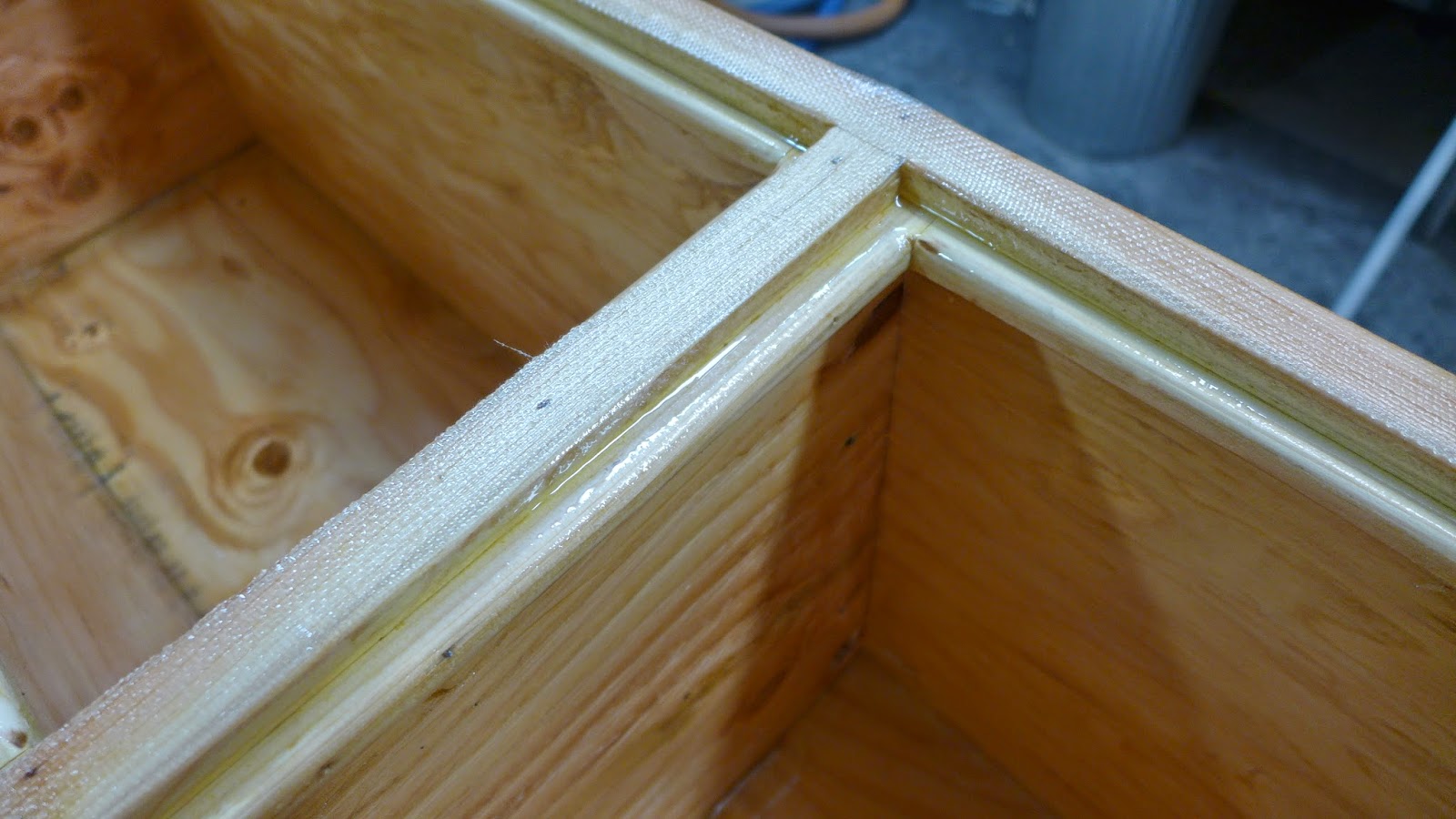

(above) With the epoxy dry, the case gets a fast sanding, then the face frame and inside get the epoxy treatment...
(above) A denatured alcohol thinned out coat of epoxy is brushed over the entire inside, working the horizontal surfaces then rotating the case...With the epoxy still wet, fiberglass tape is laid into the epoxy for structural enhancement... Next another coat of epoxy is brushed onto the glass...
(above) The only epoxy i'll use...
(above) After folding down the loose fiberglass it looks like this...
(above) The face frame 'back-lip' detail is intended to add a measure of waterproofness to the doors and drawers...
(above) Finally the cases get rotated and another 'weave-fill' coat is rolled on...
