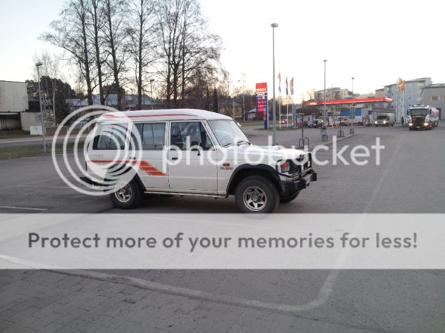

ok so i am goigto start this tread to fix up my pajero gen1 89´ 2.5 td ic LWB and to improve my english writing.
well i brought that pajero about 3weeks ago and the first week i spend welding that frame up coz of rust....then the brakes went in city trafic rusted out pipes... while i fixed the brake pipes the fuel line went and all the diesel came out LOL.
week two it had a a oil leak in the front and i opend the timing belt housing and chaced the belts and tightners/water pump and oil seals for crack and 2 balance shaft seals. the belts for the altenator and steering i also chanced but now altenator is olmost done... well ill drive it until it goes.
now i have a oil leak in the cluths end.....
i have to say that the lsd in the back works surprisingly well every body told me that they dont work, with those km´s (333400km) the guy who ownd it b4 me hatto have chanced the oils in the diffs often.
pics to come..........

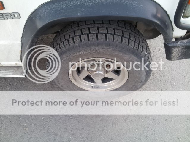

one tyre has a broken side wall the tread makes a about 5cm curve in the midle makes the same saound like semitruck trailer when the tires i about to explode LOL never buy nokia tyres......
are cooper discoverer M+S any good ?? 4 tyres with no studs are 550€ 235/75r15. for some reason it is har to find tyres in short notice.
off-roader
Welcome. Sorry to hear about all the issues. It sounds like the previous owner was eithernot properly maintaining the rig especially for its age/mileage.
The cooper tires should be fine although for the price (here in the USA) BFGoodrich ATs are hard to beat for regular road use. Pirelli scorpion AT's are supposedly better for snowy roads.
For off road use, BFGoodrich MTs are well regarded as are Goodyear MTRs among many others.
Falken also makes an inexpensive tire that's decently aggressive off road.
HTH.

o got the cooper tyres they are silent then the old nokia tyres that i had and alot more traction but they are abit sasquatsch!
