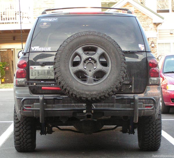

JamesDowning
Found this with a quick google search:
http://www.trailerhitches.com/hitch...urce=gbase&gbid=Spare_Tire_Mount&TID=CTM31006
Receiver-hitch mounted spare tire carrier.
Might be a nice, low-buck alternative for someone who needed to move the spare out from underneath the truck but didn't want to shell out $1000+ for a custom rear bumper & tire carrier.
If you want a solid, low/mid buck alternative, check out CBI offroad. They custom make a drop-down, receiver-mounted spare tire carrier to your specs. For those of us that don't have a lot of aftermarket support for our vehicles, it's greatly helpful!
Total cost of mine was $300. Much less than the cost of a custom bumper + swingout.

Martinjmpr
Wiffleball Batter
James: That's actually a pretty cool setup, and you can't beat the price!
I also like the fact that it leaves me the option of keeping my vehicle stock. I can put on the tire carrier for an off road trip, and then when I get back to "civilization" I can put the tire back underneath the truck if I want.
Might have to shoot them an email...
