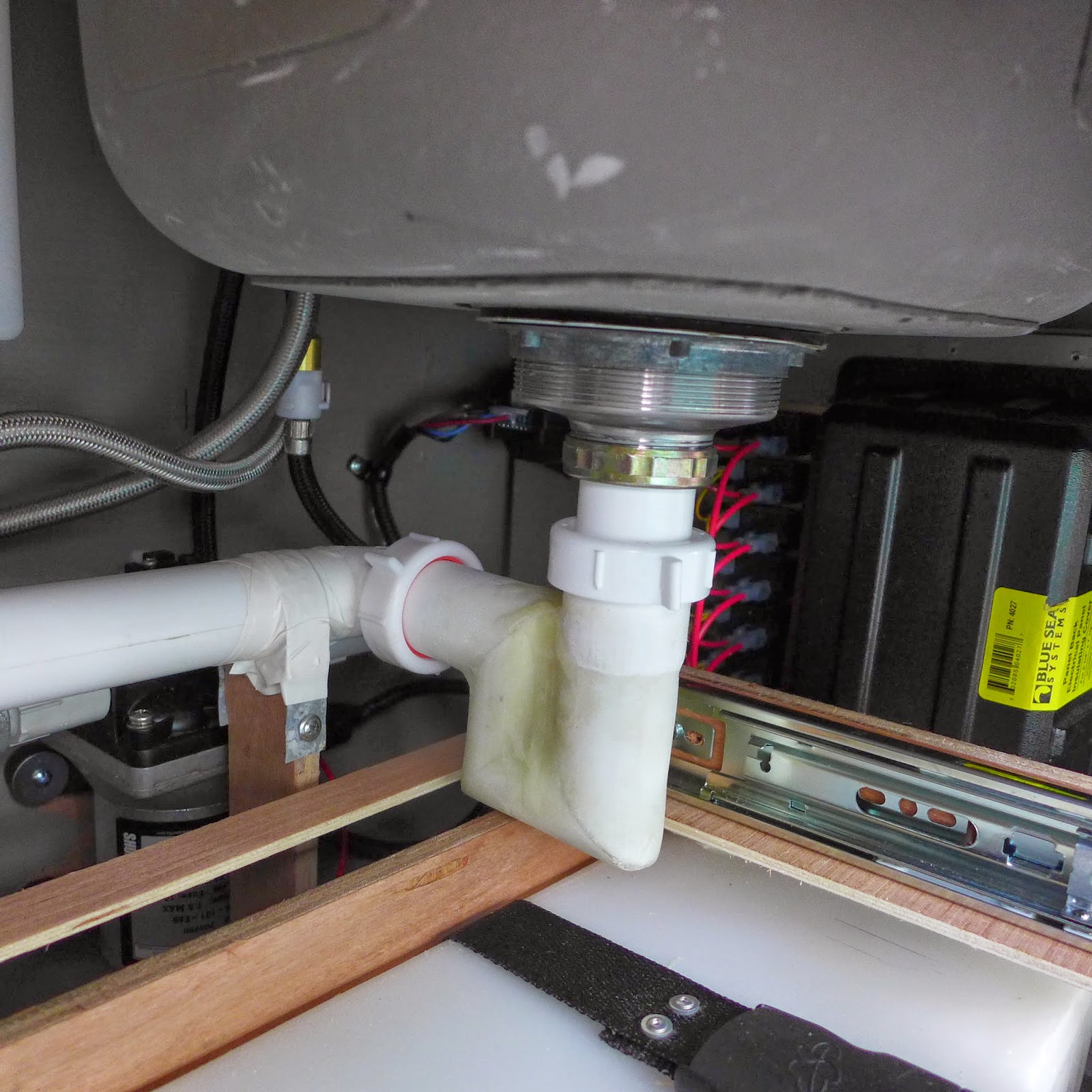

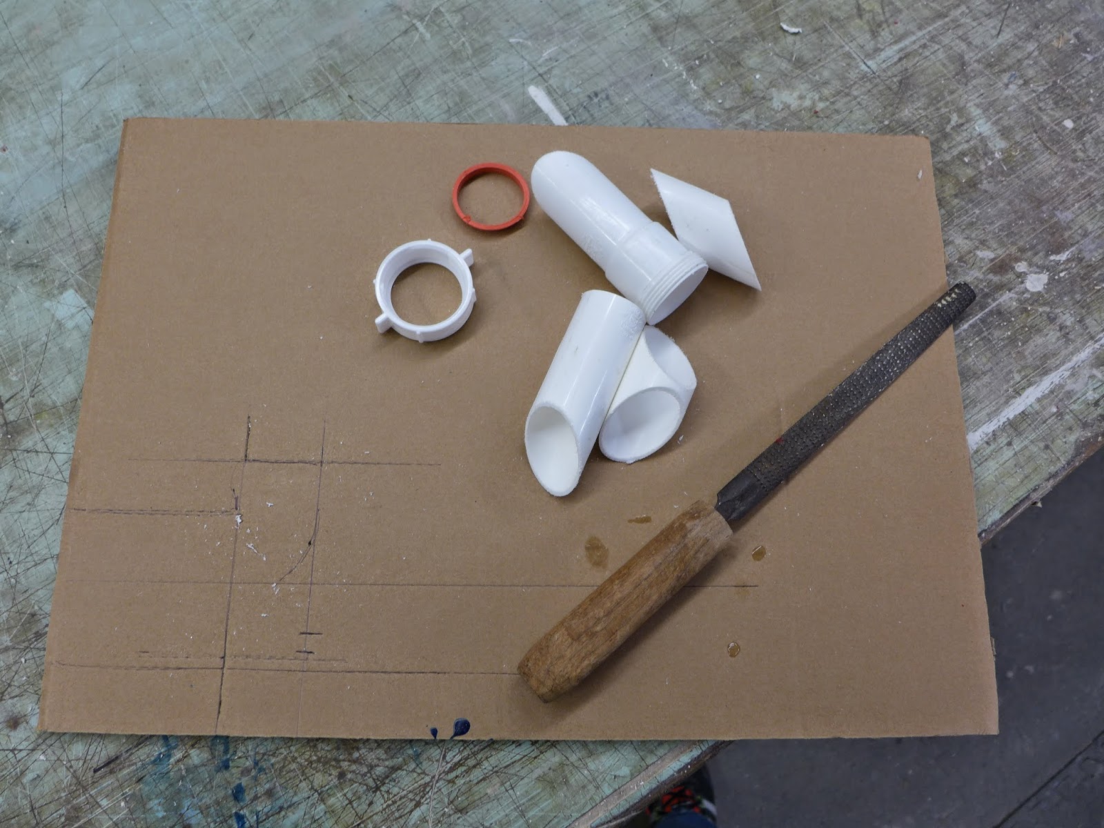

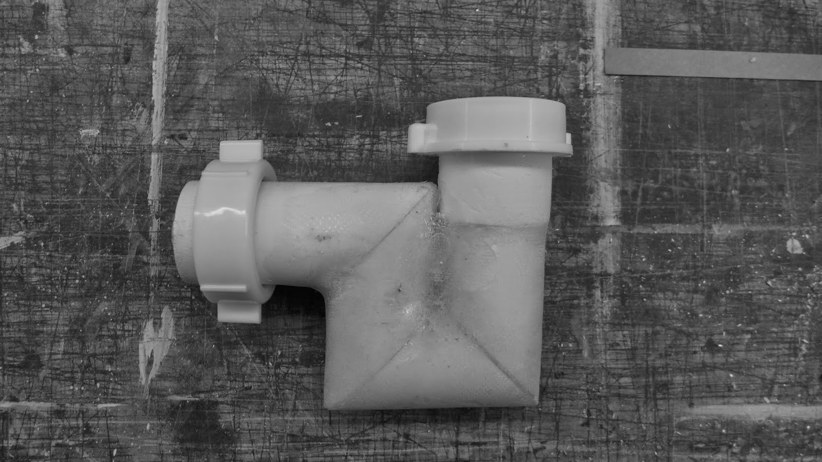

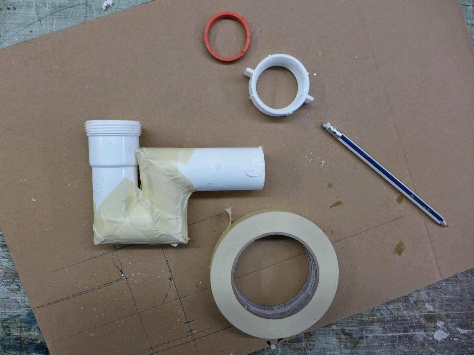

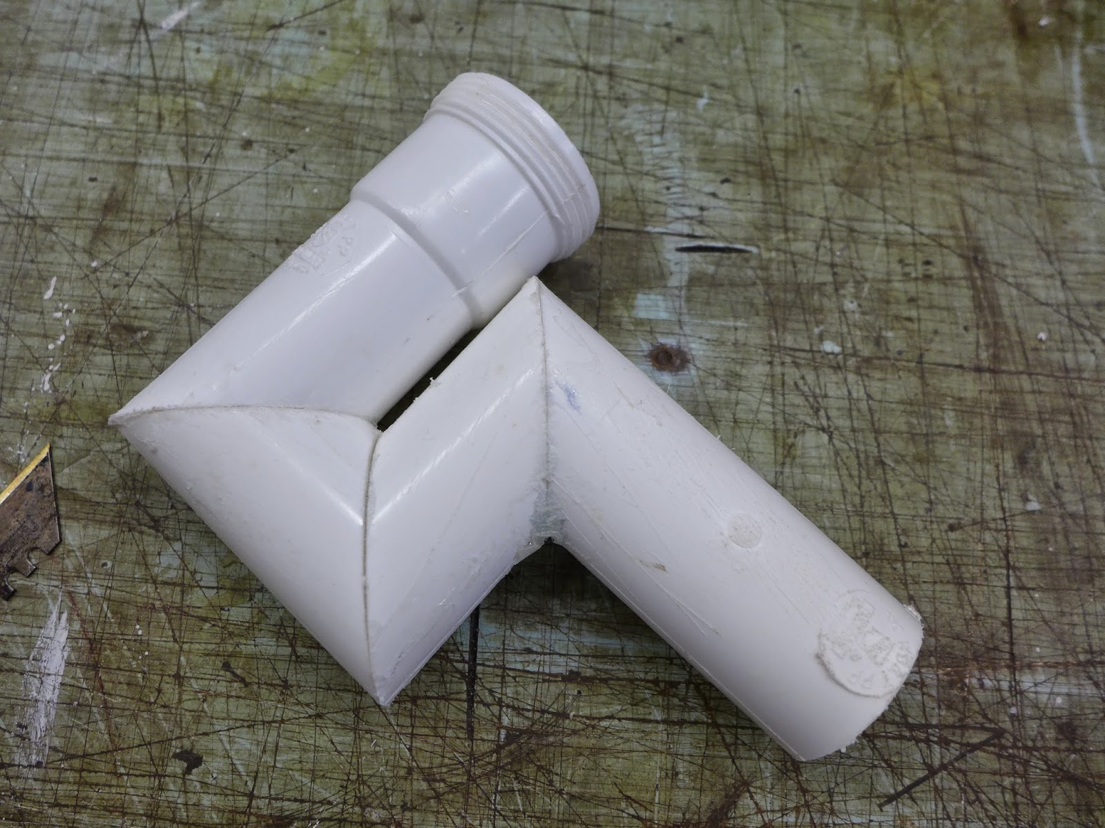

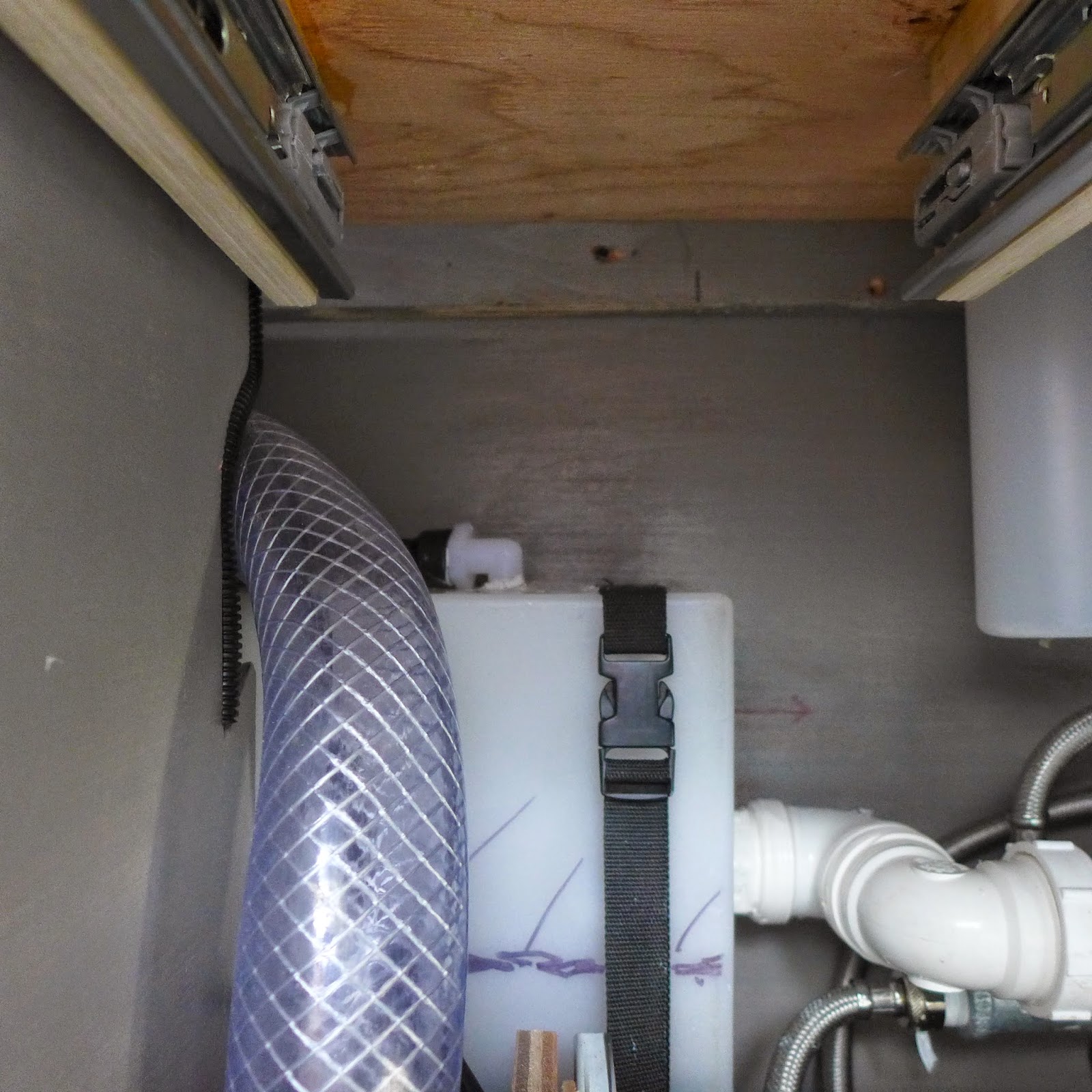

(above) Wanting to have the drain system be as sanitary as conditions allow, I built a custom, tight-space, P-trap...
(above) Masking tape it on the outside...
(above) Two pour-in and drain coats of epoxy on the inside...
(above) Pull tape and it's solid, but needs reinforcing...
(above) Four layers of fiberglass and epoxy, rasped and sanded...

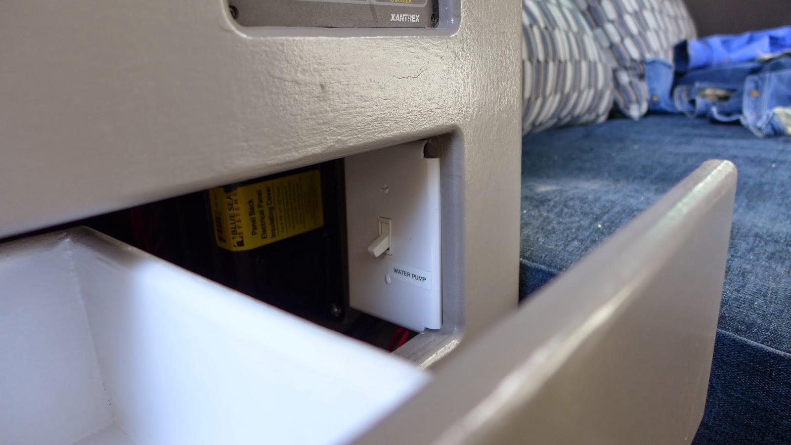

(above) A remote on/off switch for the water pump...

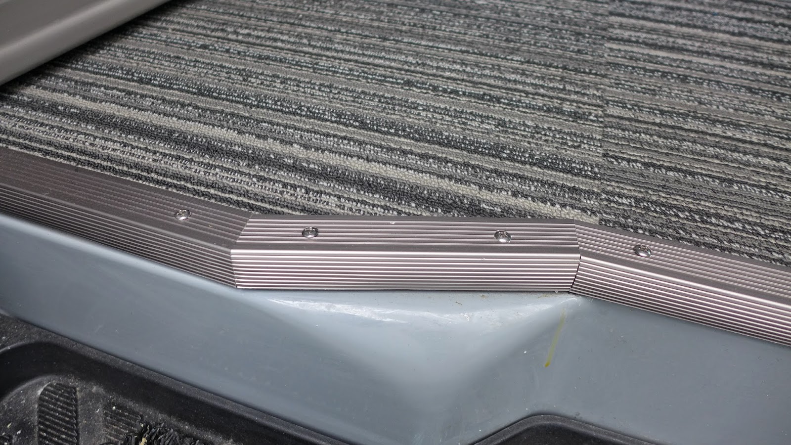

(above) Aluminum carpet edging...
(above) Ten degree miter cuts...

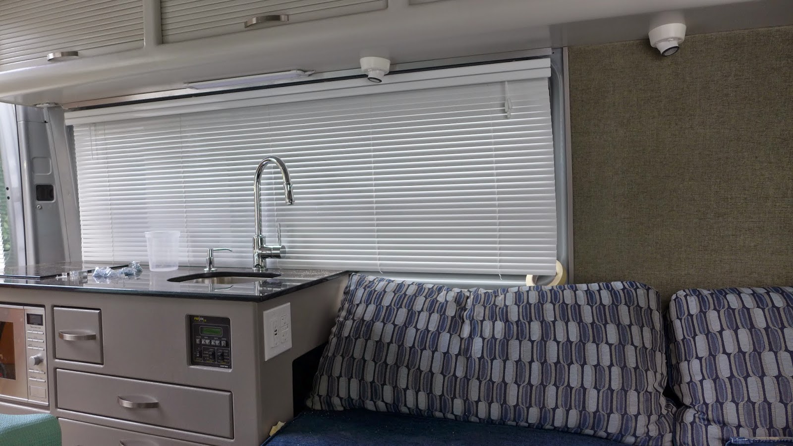

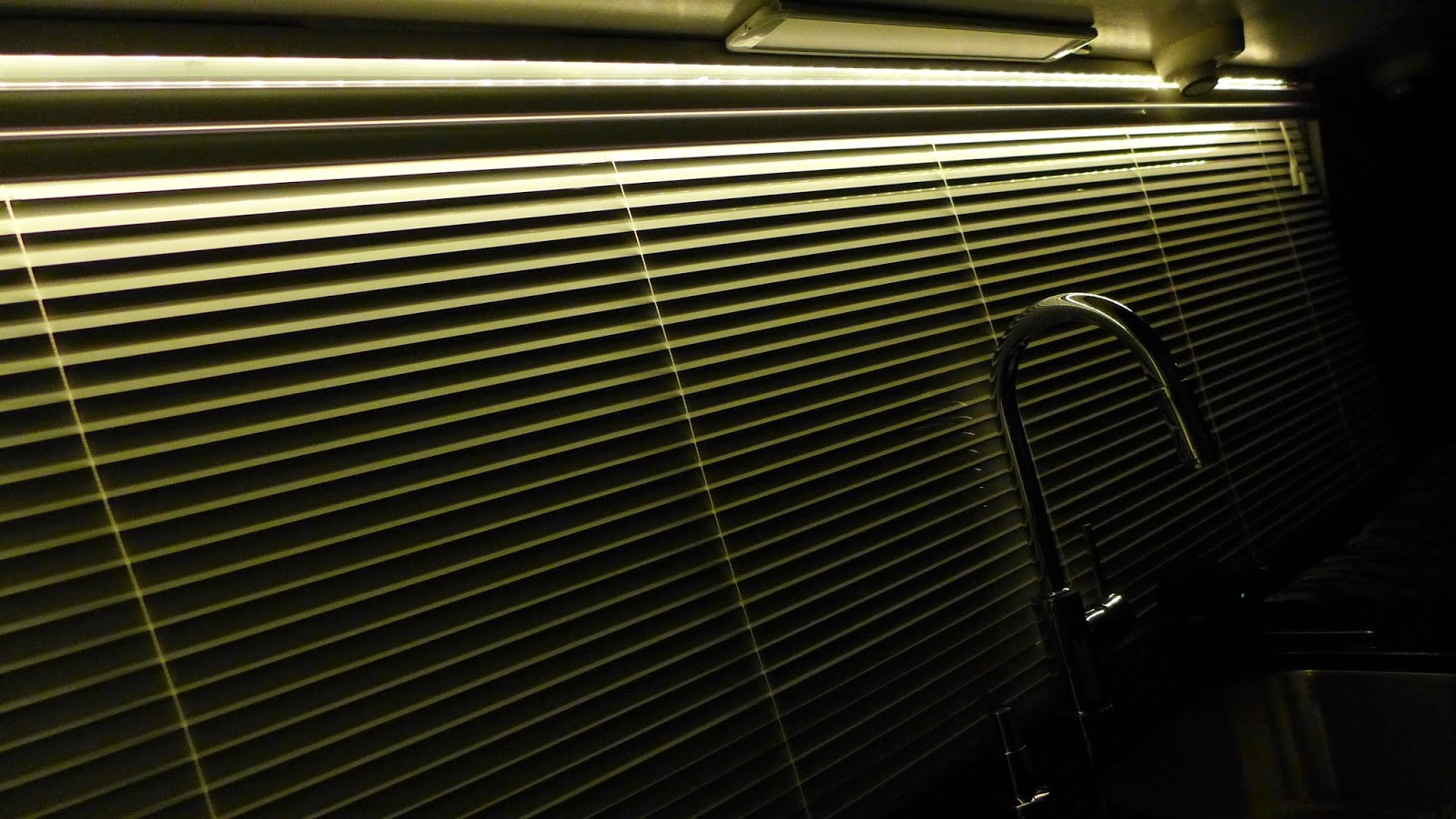

(above) Vertical mini-blinds...Custom cut for height...
(above) Testing the rope lighting...

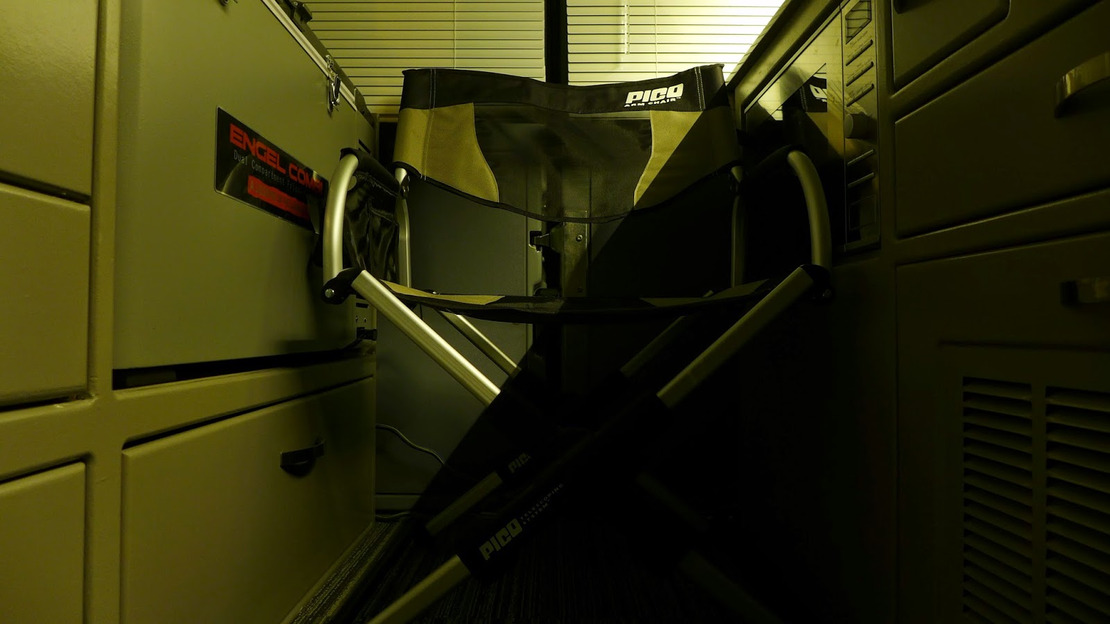

(above) And, a Pico chair in back, with inches to spare....!!!...Yesss...!!!...
Yep Paul let it drain on the ground! Use the proper soap and you have no worries.
Don't encourage Paul. He and I have been arguing about this for years. ;)
There are lots of people like Paul who see no problem with the grey water on the ground or, at best, into an open bucket. But remember that we're not talking primitive camping here. They'll be dishes to wash and food and grease will get into the waste flow. I worry about the smell that you get and the flies that will accumulate. Given that there are thousands of posts on RV forums about stinky grey water, I suspect my concerns are justified. (We'll see; with its current interior vent, I'll have plenty of motivation to keep the grey tank clean and fresh.)
I also find it semi-gross to pull into a campsite that has a big puddle of waste water from the previous campers. I'm not righteous about this, and if people used common sense, there might not be issues. But clearly not everyone did, so the majority of campgrounds prohibit dumping grey water on the ground. And many states have a law against it. In Oregon, for example, it's illegal for an RV to discharge any waste water (gray or black) on the roadway, in a state park, county park or city park or beaches. Given that I'll be in these places a lot, the whole issue is sort of moot and we will be using the tank.
I love that close quarters P-trap. I really enjoy this thread, It's fun seeing what can be done with plenty of imagination and skill.
Keep posting, I consider this my daily inspiration and ongoing education.
Having camped in hot, fly-prone, weather for a week last season: smelly stuff management is really important! By day 5, we were overrun with them to the point that we considered moving. This was from normal crumbs, garbage bag, dumping a little soup a little too close to camp, etc.

(above) Custom P-trap installed...
(above) At the top of the tank the new vent that draws air from outside of the vehicle, is installed...This, along with the P-trap will keep the interior free from any waste water tank odors...I aim to please...

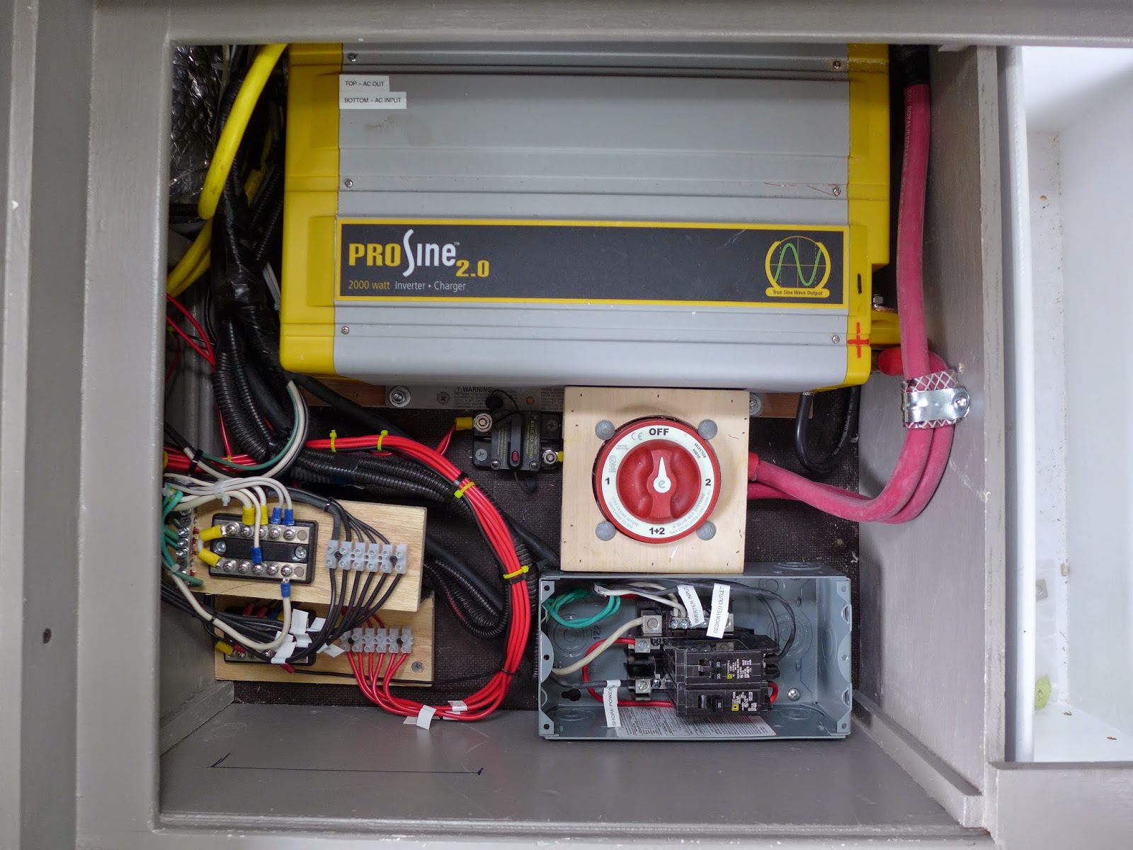

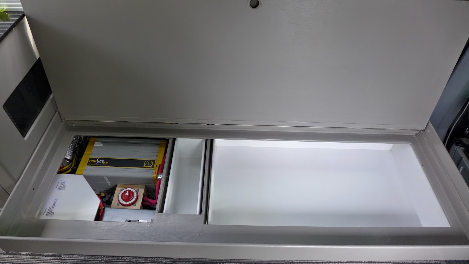

(above) I finally got around to finishing up the inverter/breakers/junction box work...Whew, what a job...

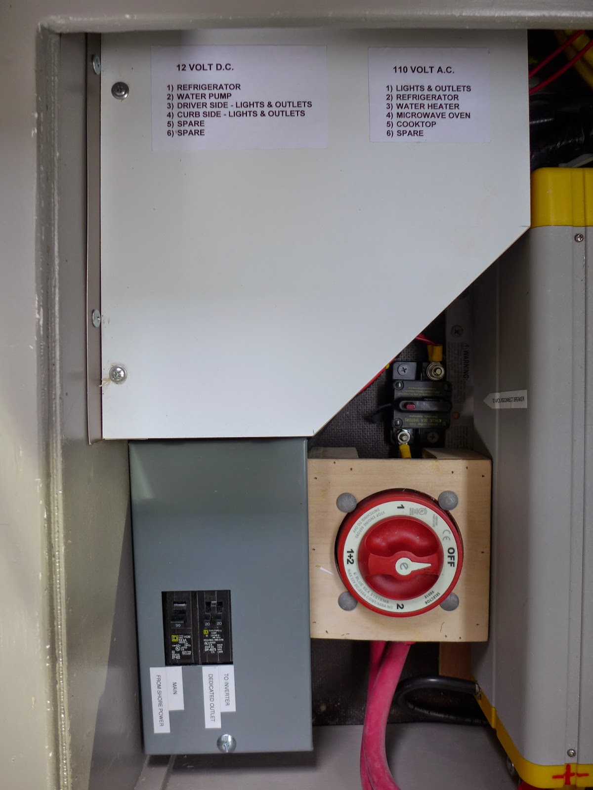

(above) Cover panels in place and labels on...
(above) Finished...At least here...For now...
