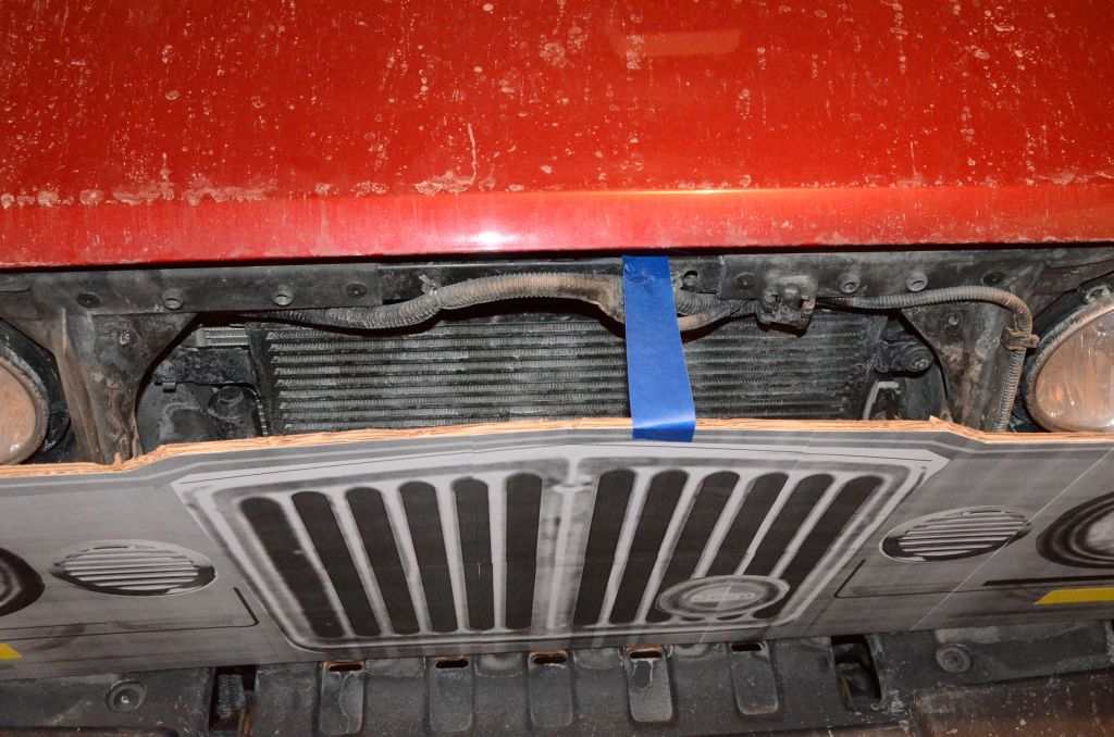

I took the factory grille off the JK so I could make some exact measurements for the new Rhino front panel to determine the length of the new Rhino hood that I'll be making. The front panel on the original FSJ angles forward about 10 degrees and I plan to duplicate that angle with the new panel, so the new hood will have to be longer than the factory JK hood. While I had the grille off, I snapped this photo, it shows how the slots in the new Rhino grille basically cover the entire area of the JK's radiator, so there won't be any problem with airflow.
This also shows roughly how much longer the new hood will be. The new hood will be 45" long; the JK factory hood is 39" long. The FSJ Rhino hood is 48" long.
