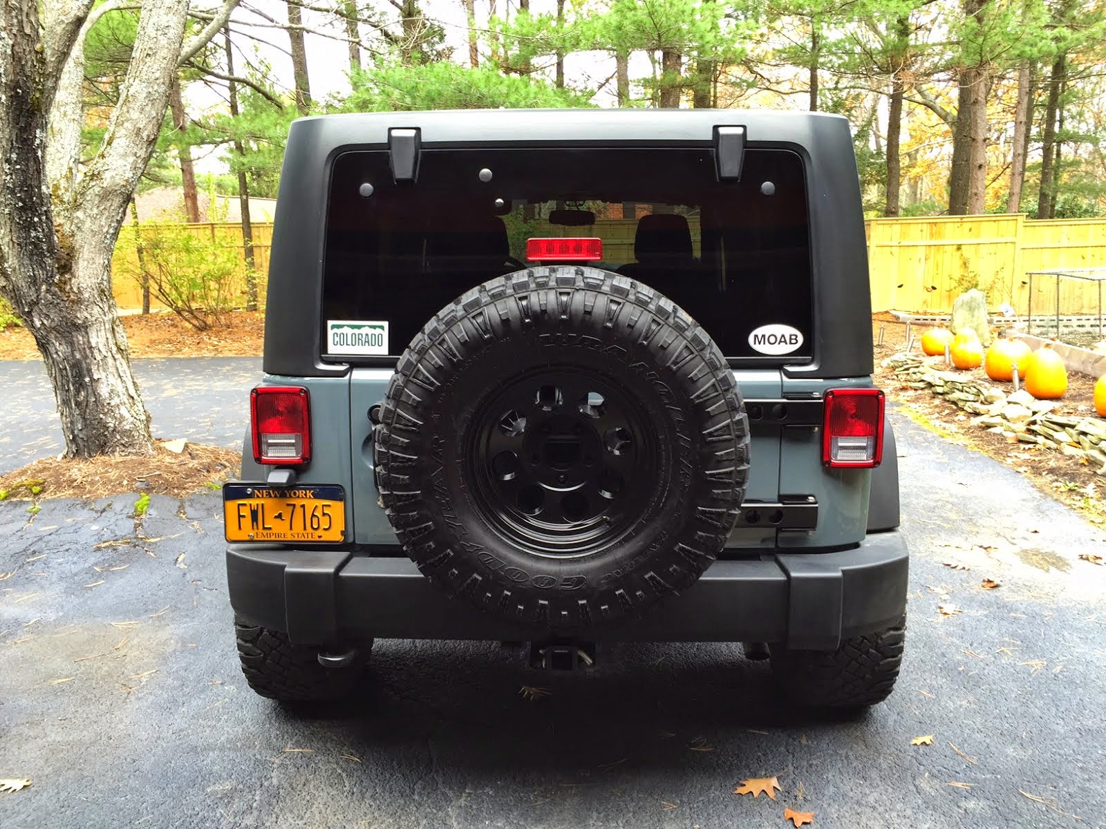

Barn Door for JK factory hardtops
Im running 33/12.50/15 Duratracs on aluminum wheels. They have a pretty good offset also so it hangs quite a ways from the tailgate on the stock holder. These new hinges will take care of that worry plus I'm confident I can add a hilift mount back there with no problem now.

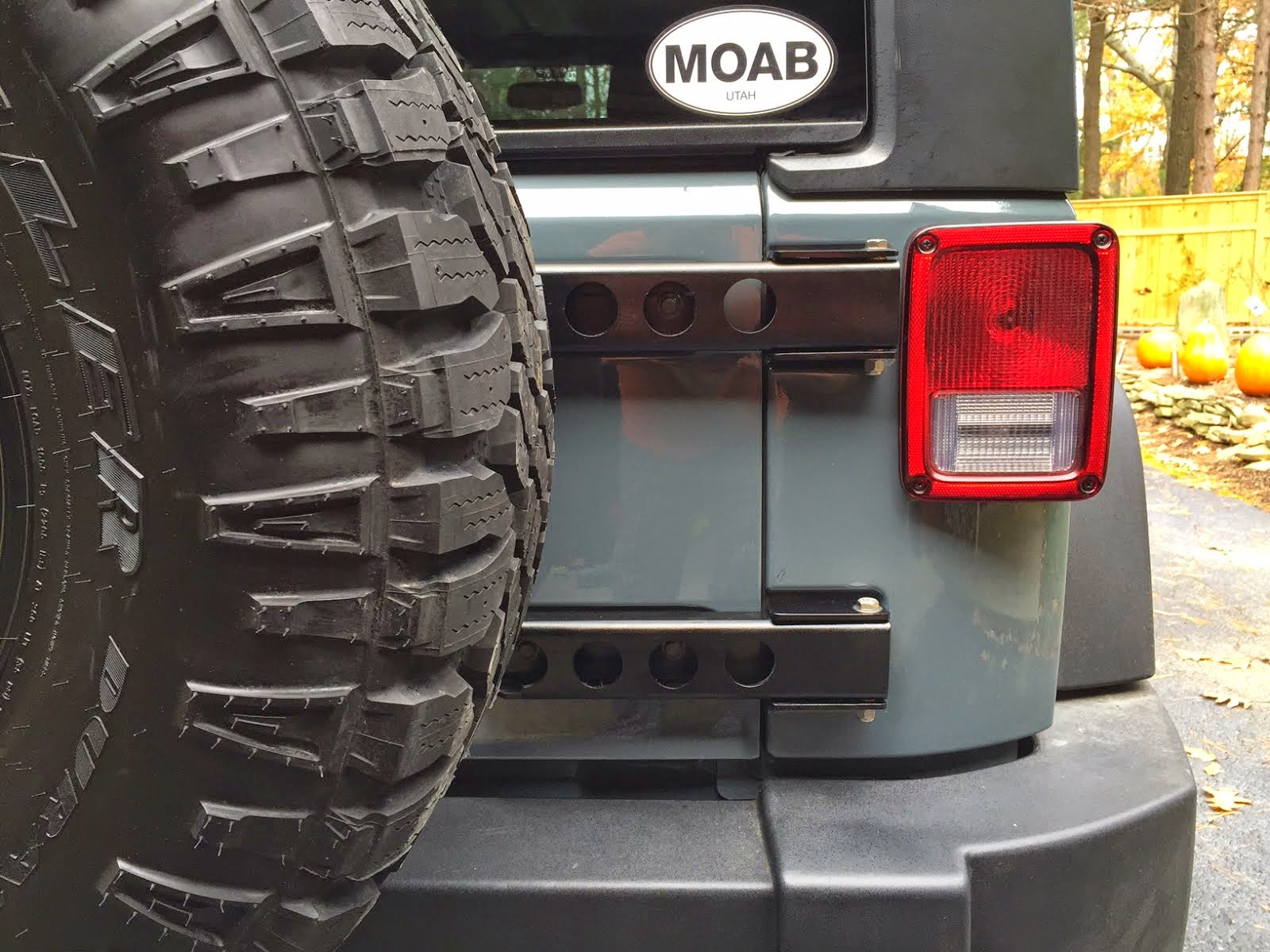

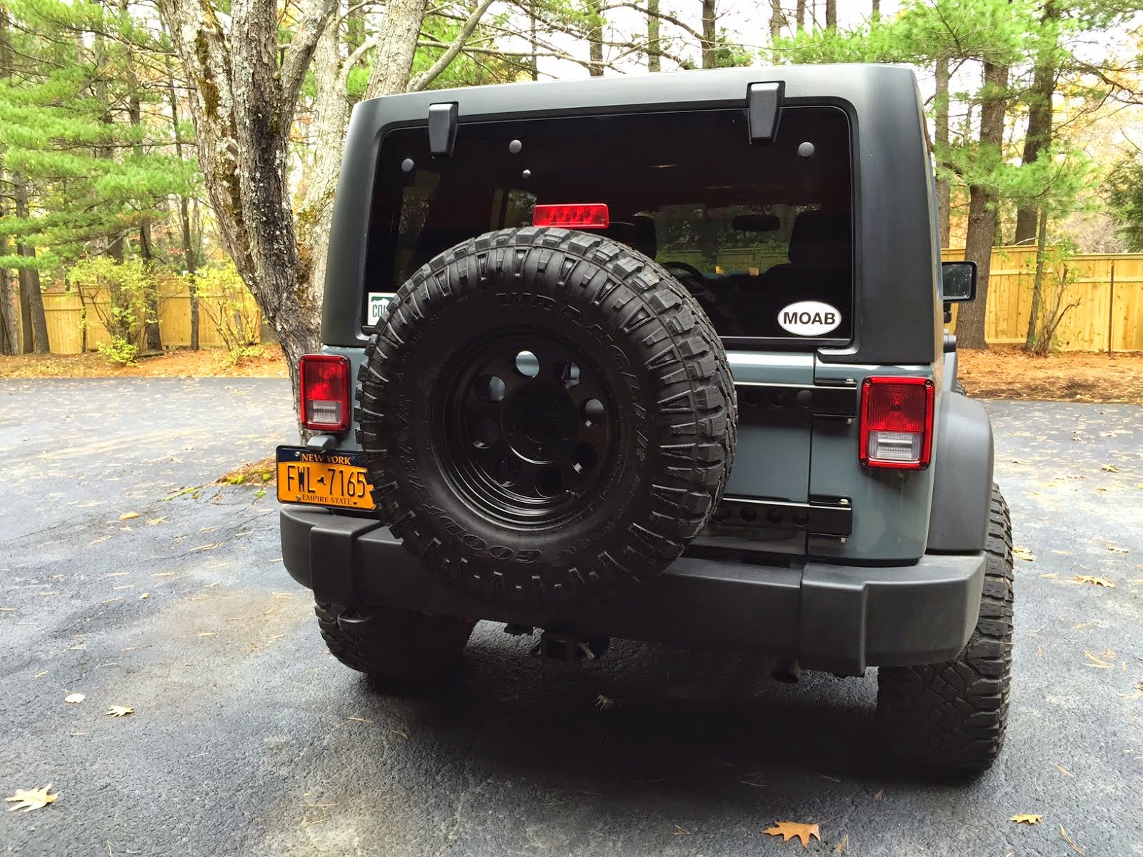

First I want to thank Jeff for his time and his help making up my set of hinges.
These are very impressive when you get them bolted on. The tailgate feels more secure and mine closes much easier than stock.

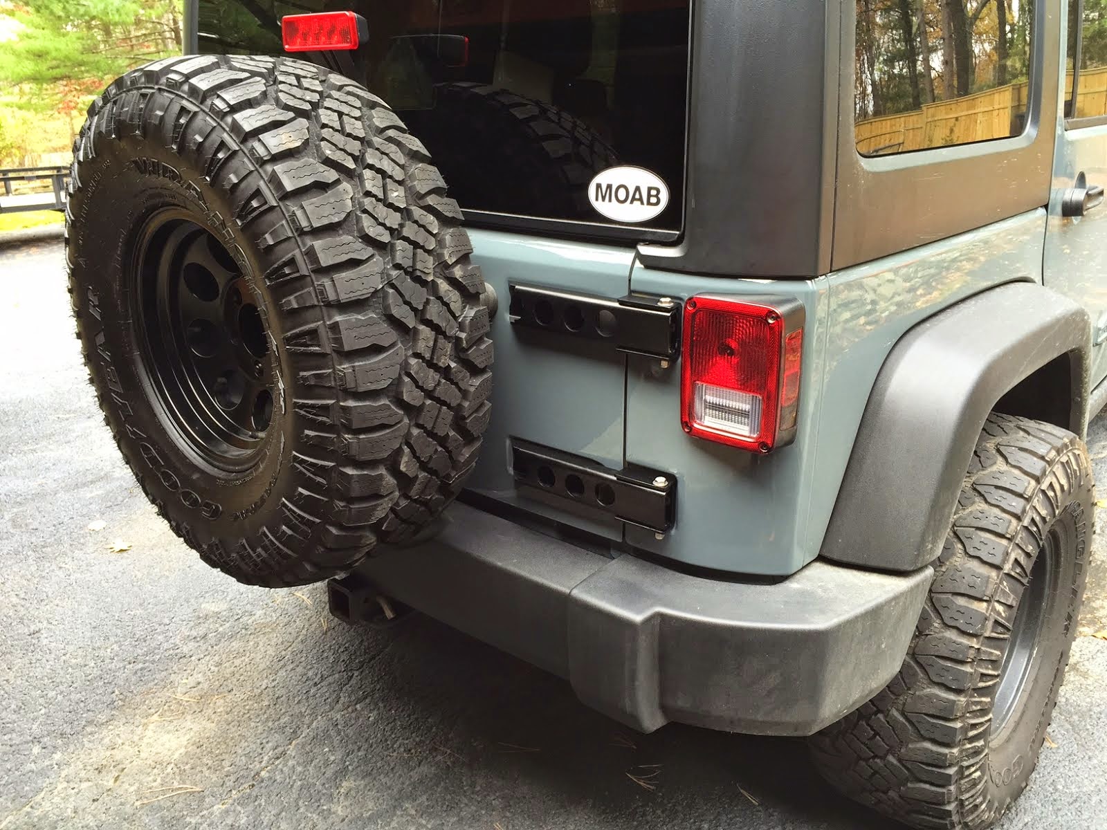

Now to some pics of them installed.
Those look really nice, Tom and Jeff! I'd love a set, with a jerry can mount. :wings:

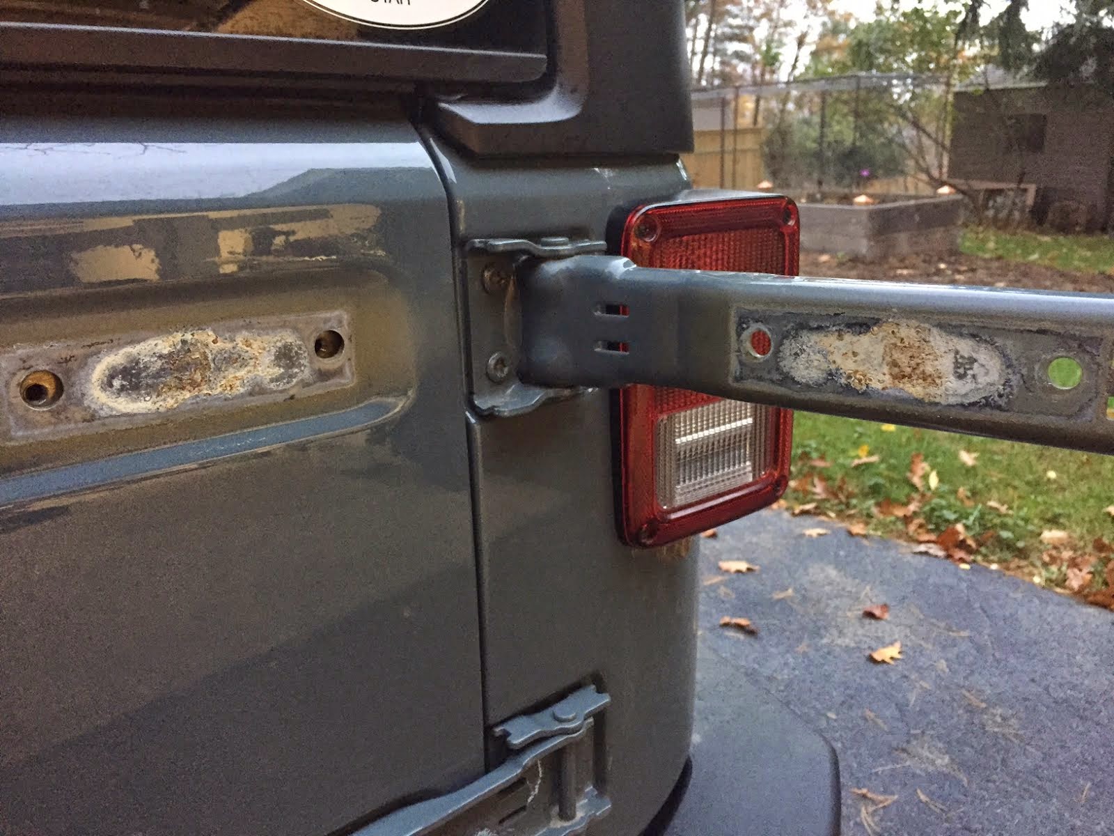

In case you need another reason to change hinges....here's the amount of oxidation on mine and it's only a year old. If only Chrysler wouldn't cheap out and actually prime the surfaces before assembling for final paint.
Wow, that's disappointing to see. You'd think they'd at least put a gasket of some sort there. Hmm...I may do just that as preventative maintenance before winter hits. :Wow1:
The hinges look good! I was kinda hoping they would tie into the tire carrier because I'd like to be able to add a trail rack but they sure look solid.
Nice work.
