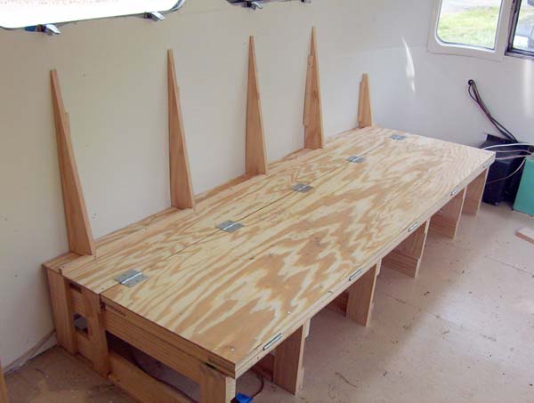

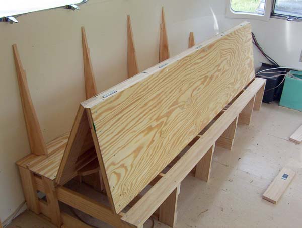

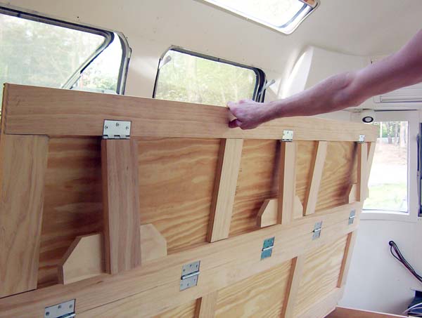

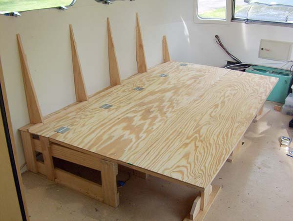

If I do a full couch/bed thing, I may do something like this. Most of the time it will be just me sleeping on it, so this will give me the option of having a single or double bed. Of course, I'll still have the wheel well and outside compartment box underneath. If I remove the top of the existing bench and go down to the lower platform and then install this slat arrangement on top of it, I will be at the right height by the time I add 7" firm foam cushions.
http://deepredmotorhome.com/bed.php
What I like about the meshed slat construction vs. the bi-fold construction is, it can be deployed simply by lifting slightly on the front edge and pulling out each section. With the bi-fold design, you have to lift the entire thing up (and possibly remove the cushions) and then fold out the second section and drop the legs. Plus, the slat design can be pulled out a little or a lot, depending on the width of the single bed I want.
