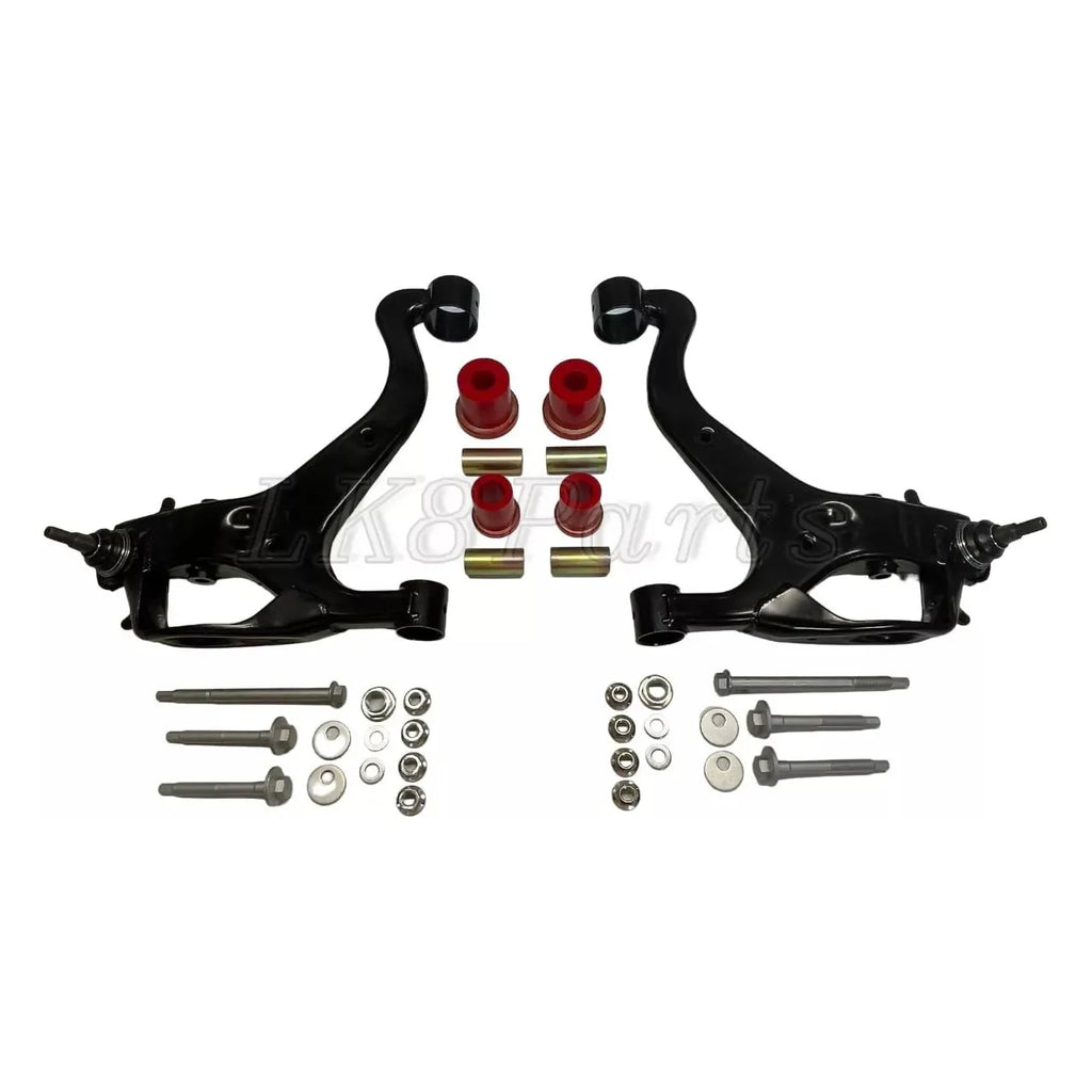

Lucky 8 with orange polybush - $358 with hardware

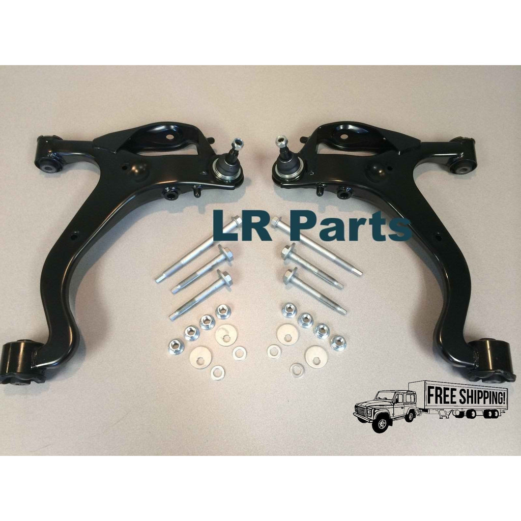

Lucky 8 Regular - $230 <- These sound like the worst quality

I would skip the orange polybush bushings. I do a fair amount of offroading, along washboard roads so when the OEM bushings wore out, I replaced them all with orange polybush. My rear UCA eyelets broke a few years later. I found out I wasn't the only one that suffered broken control arms. If you look at the European forums, they recommend OEM rubber or Meyle HD. They believe polyurethane is not as forgiving as rubber. However, Atlantic-British has complete UCA with green polyurethane bushings. They're supposed to be softer than the orange so I went with that. It's been 2 years and no broken eyelets.

After owning my LR3 for the last 8 years and trying different arms and bushings. I would have to say stick with the Meyle HD, or go with RRS arms as @tdhunter13 stated above. Stay away from Poly bush all together whether it's the stiff Orange or the softer Green. They simply aren't flexible enough to support the heavy weight of the LR3/4 models and cause cracked arms. I installed full orange Poly all around on mine and have been replacing with stock items as the arms crack. So far, both rear uppers and recently the front lower left.
I also have a friend who purchased a used LR4 in 2020 and installed brand new AB arms with green polybush and found out he cracked an arm when we were out in Moab in September. Not even 3 months old with less than 5k miles on them.
This was my latest front left lower arm failure, as you can see the collar around the orange bushing is completely gone. I loved the stiffness of the polybush on road, but failure is not an option when out on the trails.
