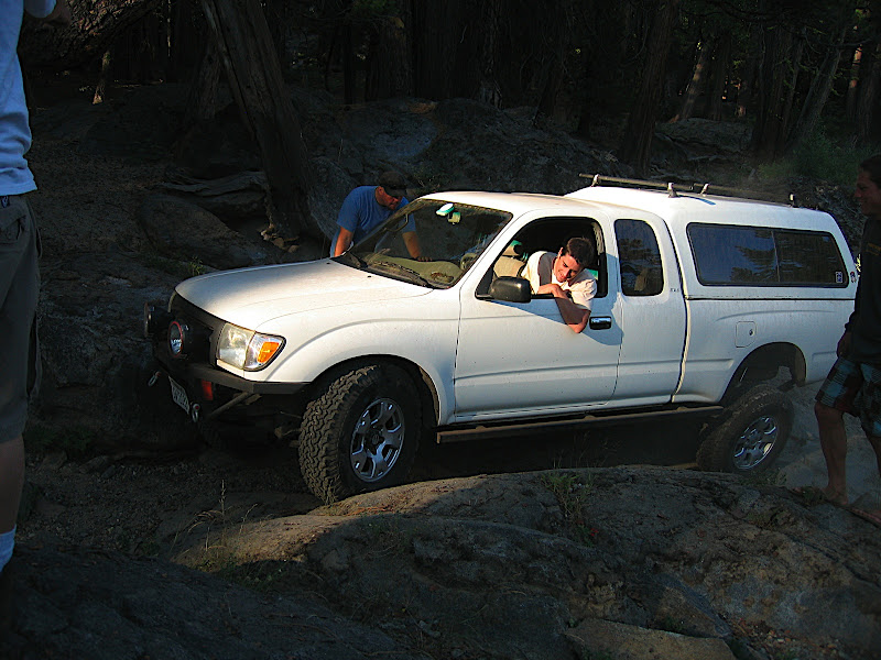

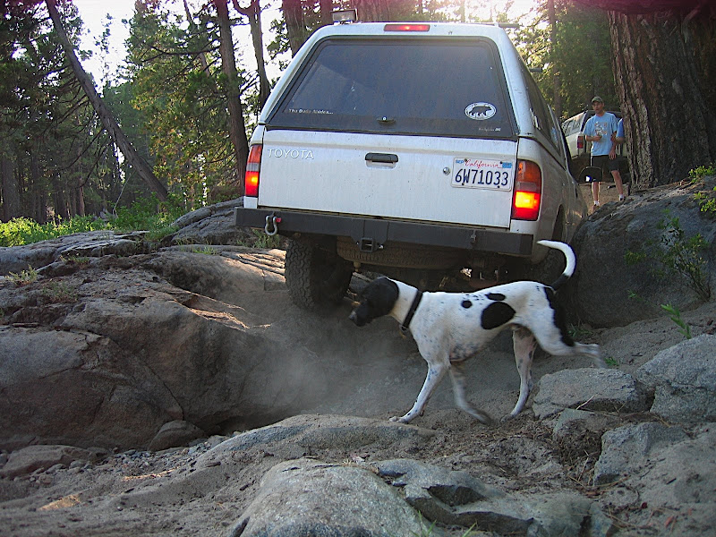

If I have to grab a little e-brake once in a while to make it lock, no biggie. To this day I have never gotten stuck with a lifted wheel even with open diffs. See exhibit A:
