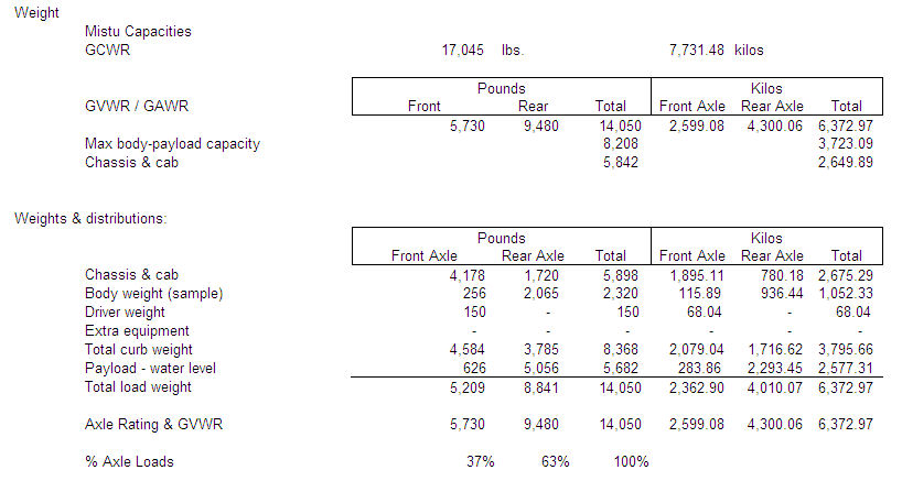

Whats is the GVW?
This info is from the data page I built here: http://www.hackneys.com/mitsu/index-specs.htm
Note that the weight distributions, body weight, etc., here are from the Fuso sample data, they are not for our rig.
Our actual weight distribution when we pulled out in June 2007 was:
Chassis (everything except the camper) % of total weight: 63%
Camper % of total weight: 37%
Front axle % of total: 36%
Rear axle % of total: 64%
Left side % of total: 51%
Right side % of total: 49%
Left front % of total: 19%
Right front % of total: 17%
Left rear % of total: 33%
Right rear % of total: 30%
I honestly have no idea how much we weigh now. We've been pulling weight off since the second week we were out, back in June of 2007. We've taken at least 1,000 pounds / 454 kilos off since then. Maybe more.

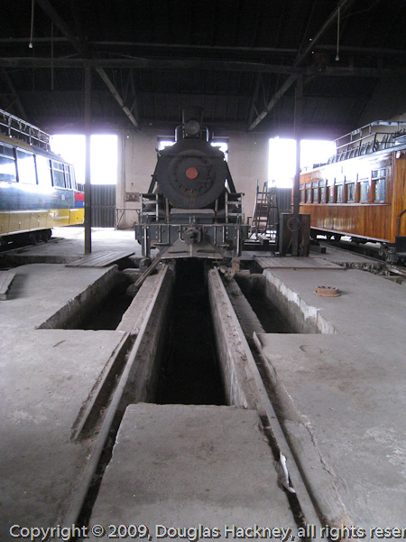

Our options are to do the work in a place like this:
Photo of the first location we planned to do the broken frame repair.
Or back in a shop such as the one we built it in (see our buildup photos here: http://www.hackneys.com/mitsu/index-buildup-photos.htm )
