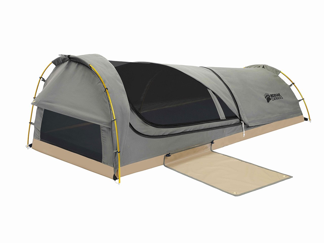

I've been curious about Australian style swag tents. I found out that Kodiak Canvas sells one in the US. It happened to be on Amazon prime, so I ordered one to check it out, knowing I could send it back. It's very well made, similar to Kodiak's other tents. Set up is fairly fast, but dealing with poles takes a minute. The open cell mattress makes it a beast. 36x12" tube. If you pull out the mattress it's much smaller. I could see it working well with a Thermarest style pad inside. But I'm not sure how you'd access the valves since you have to roll it from the head to the feet. So you can't just slip your hand it and tighten the valves. Gotta decide to keep it or not. It's probably not super useful for me. When solo, I sleep in the Jeep. My dog could fit inside with me, but it'd be tight, hairy and hot. So it could be useful if she'd sleep in the Jeep when it's just the two of us. Probably going to send it back and keep it in mind as a future option.
