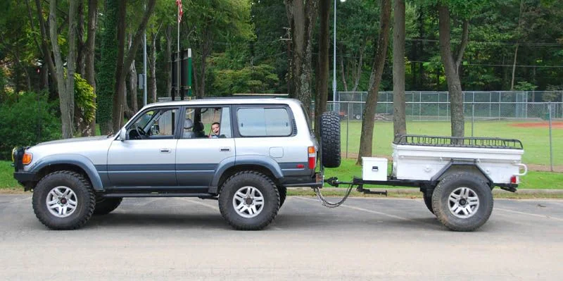

clint - thought you'd like to see your (former) baby. i put on some 10" hubs with 6 bolt @ 5.5" pattern to fit my 'yota wheels, so it's leaning less (before my truck was a lot higher than the trailer). after I took this pic, i moved the pintel position to the higher mount, so it's near level now. going to have to grind the fender corners to be safe from snagging a tread when the axle articulates - but the wheels sit farther away from the body without wheel spacers, so the body rub should be gone. sharing a spare now. RTT going back on now that i'm done with the jackstand work. are you going to the Fall Crawl at Rausch?

Looks great! Enjoy it I know I did. Not going to fall crawl but I am going to the overland rally in Vermont next week. If you want to tag along we will be driving past on wed. Morning.
