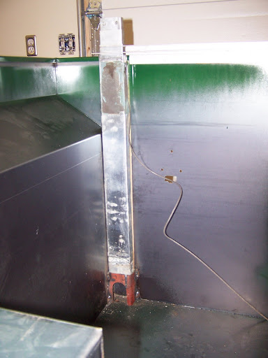

lifting
the lifting systemis off of a 60's erra tent trailer, it is madeup out of a 4 piece slider that used pullies and cables, all the cables are an even lenght and run to a centered point where they are attached to a winch for easy lifting. when lifted I will have a room with a height of 6'6". I works realy slick, I did see these at princess auto.
Thanks... my goal is to also be able to stand up...

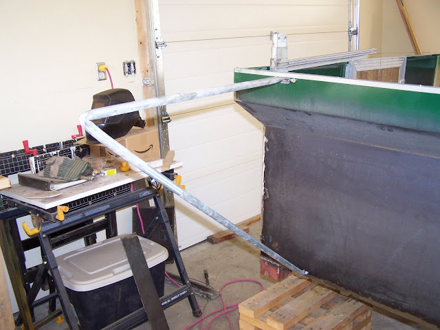

Lifting Mechanism
Rebuilding a 10,000lb winch

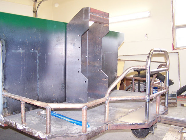

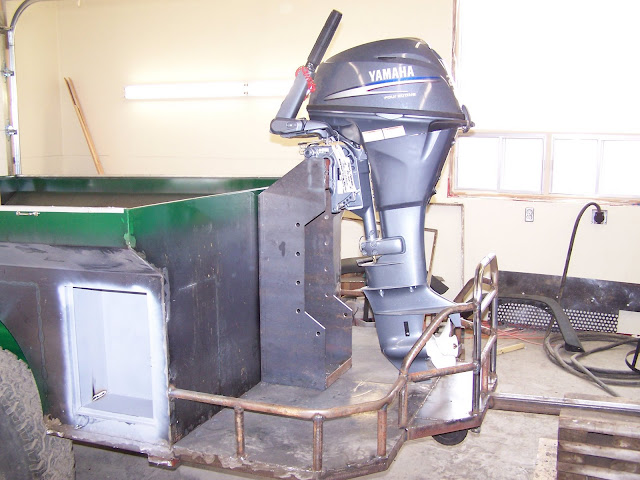

Motor Mount with protector guard
support for a slide-out bed
mount with motor in place
slide on the floor showing pullies and cables

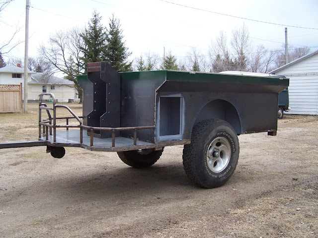

torque flex axles did not work - I could not get enough approach angle. went with a drop axel from Princess Auto, reversed the arch in the tube, put the drop up, and sprung under with the springs

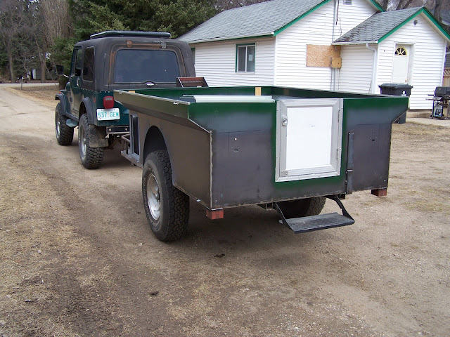

finally hooked on behind towing vehicle - `85 Jeep CJ
floating trailer
Good Idea, how much displacement do you need to float 1200lbs? Just kidding I have a 14 1/2 fool aluminum boat that will sit on top of the camper.
