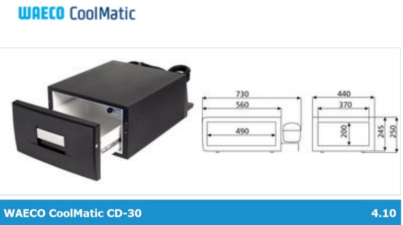

Cd-30
Has anyone tryied one of these? I found it to be the perfect form factor since you don't need to leave space over it to open nor sliders, and you can place the compressor away from the drawer, my idea is to place it on a custom compartment outside the car to avoid noise.
Capacity is 30 liters, enough for my drinking needs :coffeedrink:
I was thinking about that. That would be perfect for building a sleeping platform on top of.
