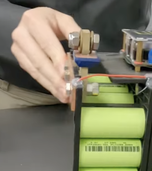

Check Your Battleborn Positive Terminal!
The problem seems obvious in the 3rd video tear-down.
There's a plastic form between the internal busbar and the terminal.
Giving benefit, maybe running it insulated with a bolt was a failed attempt to be a fuse. That's a big benefit of the doubt.
This is not ideal, the guy in the first two videos is right. This is not safe mechanically as different materials expand/contract and there's no way to fix it without opening the case or/and a redesign. Even if it wasn't the electrical tie mechanically it seems kind of weak. If the plastic cracks that terminal flaps in the wind even if happens to not start arcing.
The battery itself (e.g. cells, BMS, thermal and current protection) may be safe electrically. This is a failure at the fuzzy boundary between battery and load.
The heat and arcing here is creating a failure mode that's basically the same as if you didn't do a good job connecting it on the tab. The location of the heat in proximity to the cells is more problematic, though.
Being internal in a case that is not intended to be opened or serviced it's incumbent on the supplier to do better. It would be different if the user could open the enclosure to inspect, look for deformation or loose fasteners. Maybe some iterations have a fuse or breaker to bridge this spot.
Since you can't do any of that it's on them completely. I would be concerned if these are in your system. Relying on the epoxy discoloration to indicate overheating isn't a comforting prospect.

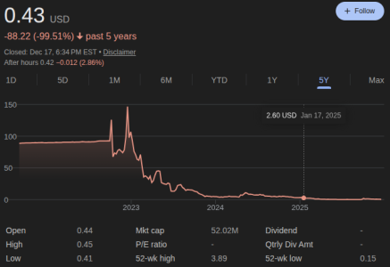

Their stock is basically worthless now vs during the pandemic. It's not just the problematic business model.

So Will Prose kicked a hornets nest with a teardown video of a failed 100AH BB by showing that it was, according to him, a design flaw with the mounting of the positive terminal leading to overheating, melting of the plastic frame through which the + bus bar was bolted to the + terminal using an aluminum bolt.
The + terminal was loose and wiggling, the bright red epoxy seal was heat discolored to brown, the votage and current were dropping out and there was internal arcing inside the case.
Battleborn has made this exponentially worse by responding very defesively that this is an intentional failsafe to prevent thermal runaway, which maybe is true as there appears to be no cases of runaway, but . . . .
