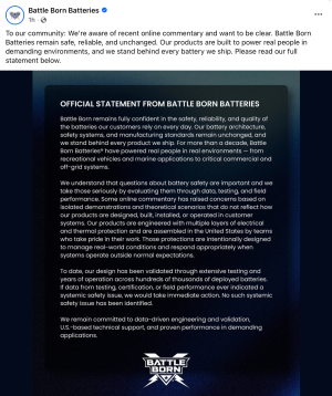

I've been watching the Battleborn facebook pages and wow, they pretty much immediately delete any comments on this issue. Denying it (IMHO) is very bad. They should just address the issue. I'm sure it'd be expensive to "fix" all the BB batteries out there but the other option might be worse; lawsuits, etc.

And then with the typical corporate ass-covering in an attempt to avoid the comprehensive recall order they should have issued immediately, they deserve to go under. Any company that would allow such negligent design where such hazards lurk should cease to exist.
Anybody that hasn't seen the forum/social media reports that HAVNT been squashed by battleborn will be ignorant to their problems.
Awfully typical, sounds a lot like a marketing crew that doesn't care about (or understand) product issues and is only worried about keeping a brand above water.
Unless they fix things fast and succeed in covering up or distracting from the terrible designs, they are on borrowed time.
There are already enough independent tests and customers claiming foul at this point, and more than enough evidence to back it up.
I cannot speak of any kind of sponsorship of any of the tests that have been done and publicized, but the evidence seems clear.
