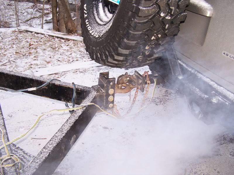

hooked it up to the jeep and it fits great. I have about 1" of clearance between the tire carrier of the jeep and the bed of the trailer, so the tounge is going to work out great as it is.

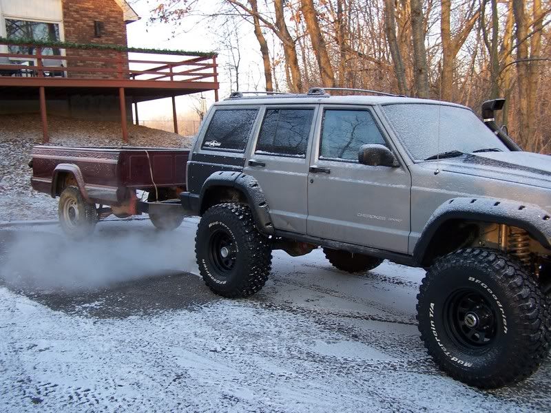

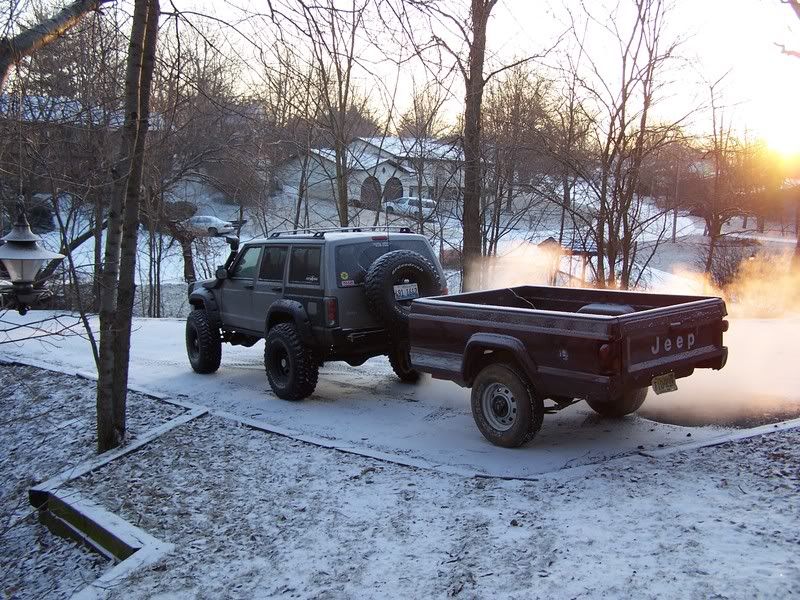

Here are some pictures from this morning, hooked up and ready to go pick up the new axle.
It sits pretty tall as is without the big tires and lift. I'm begining to worry that it is going to sit too tall, going to have to add some weight. I guess it is better to have to add weight than to remove it. I got just over 12 mpg pulling it, I usually get around 15 mpg... so not a huge drop. It will be interesting to see what it does with the new axle and bigger tires. If I figure right, it should be about the same.
It sat quite a bit lower in the first pictures I posted because Mark was using it as a rolling storage shed and had it full of axles, an engine, and a transmission.
The hitch worked out pretty good the way it was sitting. When I lift it I imagine that it is going to have to be modified a bit. When I lift it, it will sit 8" higher than it does now. It is sitting a little low in the back now, and I'm hoping for it to sit a little low at the tounge when empty to help keep as much weight on the tounge as possible. I'll probably have to trim the top off of the channel that holds the lunette ring to keep it from hitting the spare when I take it through ditches.

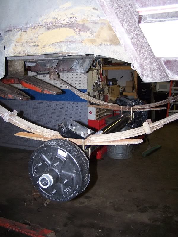

The axle was set up wrong. I ordered it to have the springs above the axle, and they sent it with the perches below the axle. I welded on some bigger spring perches, so it was no big deal. I left the old perches on just in case I decided to lower it later on. I also had to flip the spring center pins so that they faced down to match the axle.
Here is Alex, the one who suggested keeping the exhaust, cutting off the tops of the u-bolts.
The new axle is pretty beefy. The 3" axle tubes allowed me to use the stock spring plates. The wires for the electric brakes were already ran through the axle tube to protect them from rocks and brush.
There is no weight on the springs in this picture, but when on the ground it doesn't compress them much. This thing is going to be HUGE!
I am definately going to have to add some shocks soon, I was hoping to put it off for a bit, but no such luck. The MJ springs are very long and flexy. It is amazing how much suspension movement there is when you rock it.
