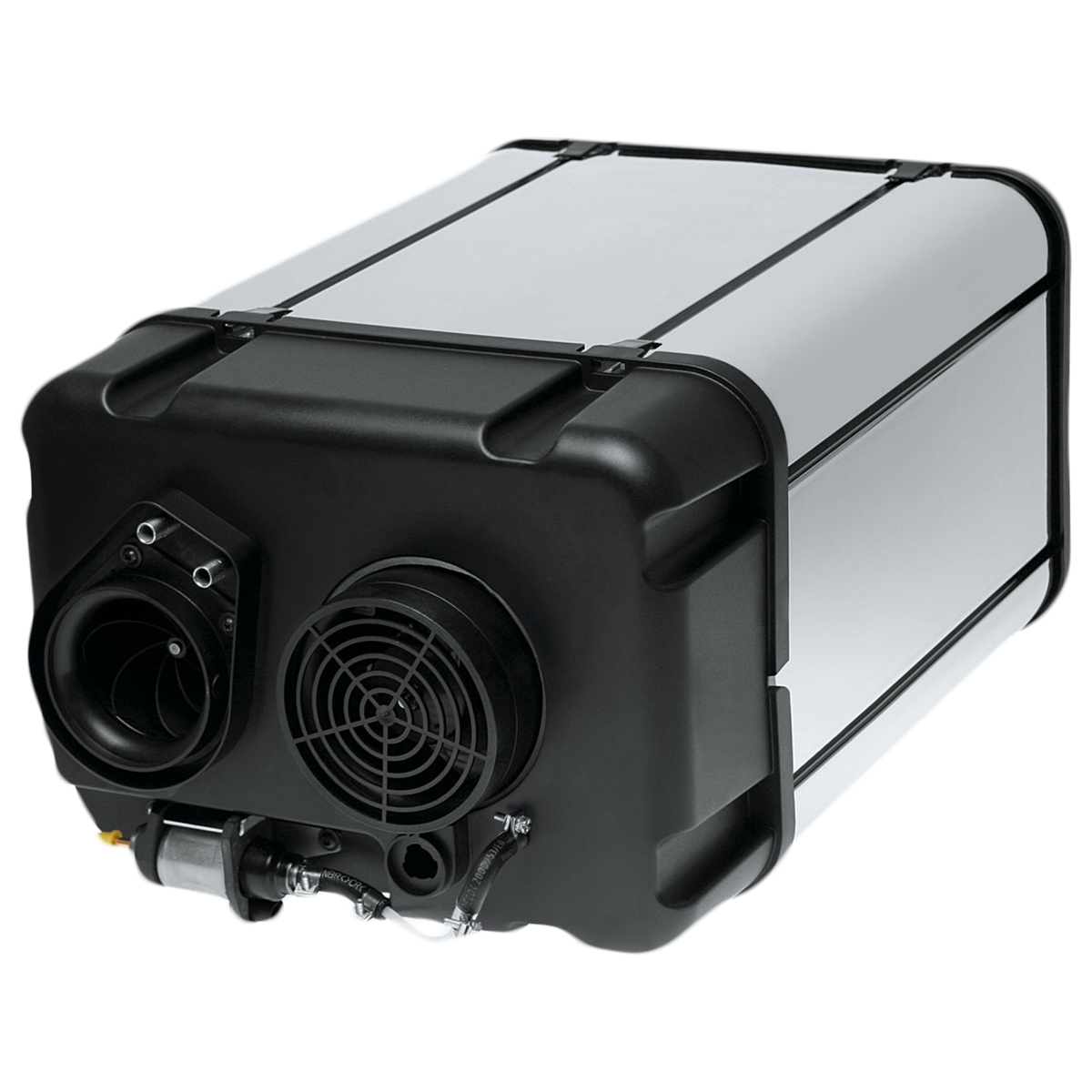

Found this post on my Class B Forum....this interesting, space saving product may be of interest to some of you DYI’ers?
Truma Combi 4 Propane Combination Water Boiler and Furnace Heater Now Available in US and Canada
“Now available to the North American market to the aftermarket!
Previously these units were only available to OEM's but we have a access to complete Truma Combi Kits (at a significantly lower price than importing from the EU, and these units are actually approved for us in US and Canadian RV's.”

~$2,200 may seem a bit pricey. But try building a system for making hot water and air that is anywhere near the compact. You would likely need 2-3x the space for a american style RV water heater and furnace. Both would require large cut-outs in the side of the vehicle. While the Truma unit can vent through the floor or wall with a much smaller footprint. Plus the variable output means much less cycling for heating the cabin.
Just wanted to touch on this, the Combi can not be vented outside through the floor, it must be vented above the unit, so a wall cutout is almost always required, but yes, it just requires a 3-1/4" Hole.

I recently installed a tankless water heater in my house and have noticed that a lot of water goes down the drain waiting for it to get hot. I suspect that this might be a similar issue with this unit since it appears that it heats water on demand rather than heating a tank full of water and keeping it hot until you need it. While this is more energy (propane) efficient it wastes a lot of water. We keep a bucket in the shower and use the water to water plants so not a big problem in the house.
In my rig its a different story I have never run out of propane in my 2 - 20# tanks but I have run low on water (33 gal fresh water tank + 6 gal hot water tank + 2.4 gal creek fill casette toilet tank ) on long trips especially in hot weather. It would be great to free up the space but not if I just need to add fresh water storage plus grey water tanks space to make it work in the real world.
Perhaps Truma can comment on this. Am I understanding it correctly that this is similar to a domestic heat on demand water heater?

No, that is not the case at all.
This is not a tankless water heater.
The unit has a 10L (2.64 Gallon) Stainless tank around the burner. The control panel will let you know when the water is to temperature, and then it will continue keeping the water at temperature as new cold water is added to the tank. The entire setup is a heatsink, meaning it retains a lot of heat as cold water is introduced, allowing the burner to not run as often. As a bonus in the winter, it will warm/heat the water as you use the furnace since the water jacket is around the burner allowing you to have warm/hot water with minimal heat loss, and least amount of propane used.
The majority of the RV's in Europe are fitted with much smaller water storage tanks (Cassette toilets contribute to this) and even smaller propane tanks.
These Combi units are by far the most efficient water heater and furnaces available on the market.
I wanted to install a Truma to replace the 60% efficient Suburban heater in our trailer but at the time just the OEM builders had them.
Installed a Propex as a backup which works great but it doesn't have enough BTU for winter use.
