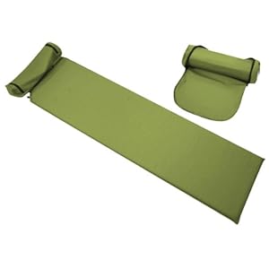

I picked up a cheap self inflating sleeping pad and it made a huge difference. It inflates to about 1" thick. I open the valve in the morning and just fold the tent up with the pad still in it. This made a big difference for me and I have no plans to further improve it.
http://www.amazon.com/Wenzel-Roll-I...GGLM/ref=sr_1_5?ie=UTF8&qid=1315502662&sr=8-5
