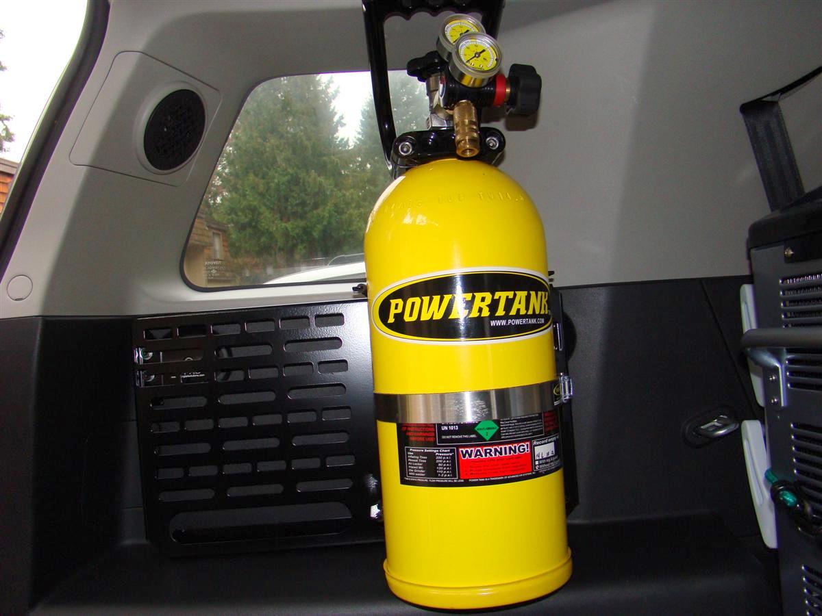

Springtail Solutions MPAC Side Rack For Powertank Installed 12-3-2011
For years now the Powertank and one of my fire extinguishers has been mounted to the top of the cargobox as seen in the first picture.
While this has worked out good, it takes up a lot of room there for valuable space for camping gear when the rig is loaded with it.
Springtail Solutions has had for quite some time now a side rack (click here to view it) for mounting a Powertank and other items via holes for Molle straps, Quick Fist mounts, and other methods.
This newly designed side rack I installed is just for the Powertank only, and also made to use the Super Bracket from Powertank that is linked at the end of this article.
This will allow me to have more space for my 7 gallon drinking water jug, a large propane tank, and my chuckbox.
Depending on how much space this opens up, it will be much easier to load my camping gear back there now.
You can see by this older picture with the chuckbox back there that there is not much room on top of the cargobox for other gear with the Powertank there.
Please note this new rack is a prototype that I am testing for Springtail Solutions, so there is no URL for it yet on their website at the time of this writing.
This rack may not even get manufactured by Springtail Solutions unless they hear from other potential customers that there is a demand for these.
Hopefully after readers here see mine there will be enough interest warrantied for them to bring this into full production, and if so, it will be priced around $20 cheaper than their current side rack.
So if there is, please contact Doc at Springfield Solutions and let them know there is a desire to have these built.
My old large fire extinguisher bracket I have had since around 2000 or so for a Powertank in the 4Runner and then the FJ Cruiser is to big for the new rack, so Doc at Springtail Solutions suggested the Super Bracket from Powertank is the one I wanted to pick up, plus Doc's side rack is pre-drilled for the Super Bracket from Powertank.
I ordered the black Super Bracket one from Steve Sasaki owner of Powertank, and it arrived in a two days.
Steve, you guy's rock ;)
Below is a picture of all the parts spread out.
Here is a picture of the side of the FJ Cruiser showing the grocery hooks in place from the factory where the new rack will go.
Remove the stock bolts with a 10mm socket.
Here is a picture of the black billet aluminum mounts that replace the stock grocery hooks.
They install with 45mm stainless steel bolts and an included Allen wrench.
Here is a picture of the side rack and the Powertank Super Bracket in place.
The side rack is held to the billet mounts with 6mm bolts and washers.
If mounting a heavy item such as a Powertank or a fire extinguisher the below step should be taken.
There are two holes on the bottom of the side rack, and you drill two 15/64 holes through the plastic wheel well.
You then secure it with 6mm button head bolts and fender washers/locking nuts with another (smaller) included Allen wrench and a 10mm socket.
Here is a picture with the Powertank now in its new location.
Another picture showing how much room was opened up by relocating the Powertank to its new position.
I will mount the Quick Fist mounts at a later time when I can do some more measuring and figure out what will be mounted with them.
Doc has an excellent installation guide over at fjcruiserforums site, and the install is the same for the new prototype rack I have.
The link to it is at the end of this article/post.

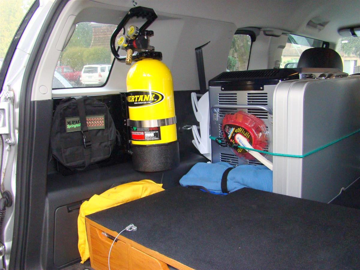

I will update this at a later date when I have the rig loaded up with camping gear to show you what it looks like with the gear and the new rack installed to the side now.

Looks like it should help you with better space management Corey, with FJ's you need every cubic inch you can get. So is the biggest difference between the old rack and this one is there is only molle mounts on one half of it?
Thanks!
Yes, the molle mounts are on the left half, and the Powertank installs on the right side.
I have a molle bag too that I might try mounting later to the left side.
Very cool Springtail one, and I will update the thread here with it later.

Thanks man, I am happy to have the extra room now.
Still need to mount the fire extinguisher though.

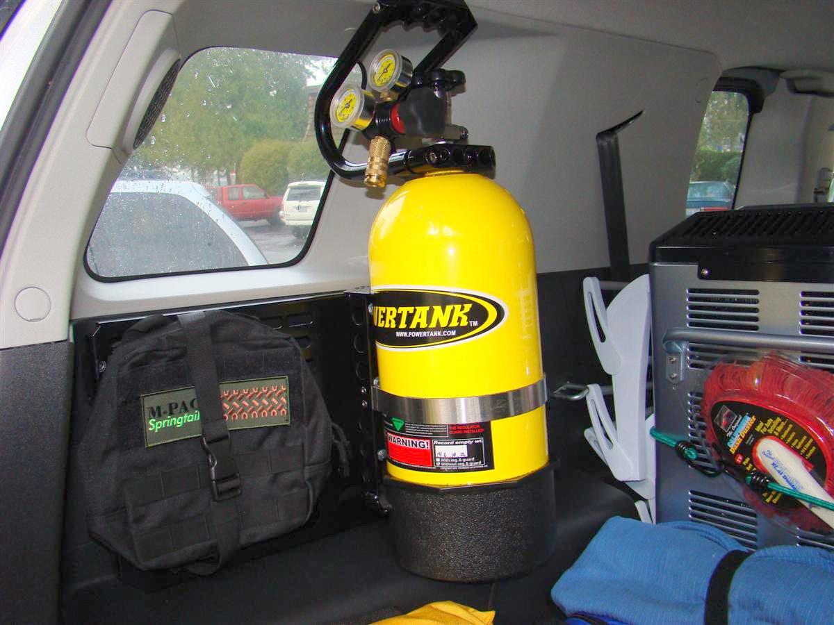

Just installed the new molle pack.
Once it is mounted via its two straps, you can grab the bag and separate it from its Velcro backing, thus leaving just the mount hooked to the rack, and you take the bag with you which has a carrying strap on top of it.
