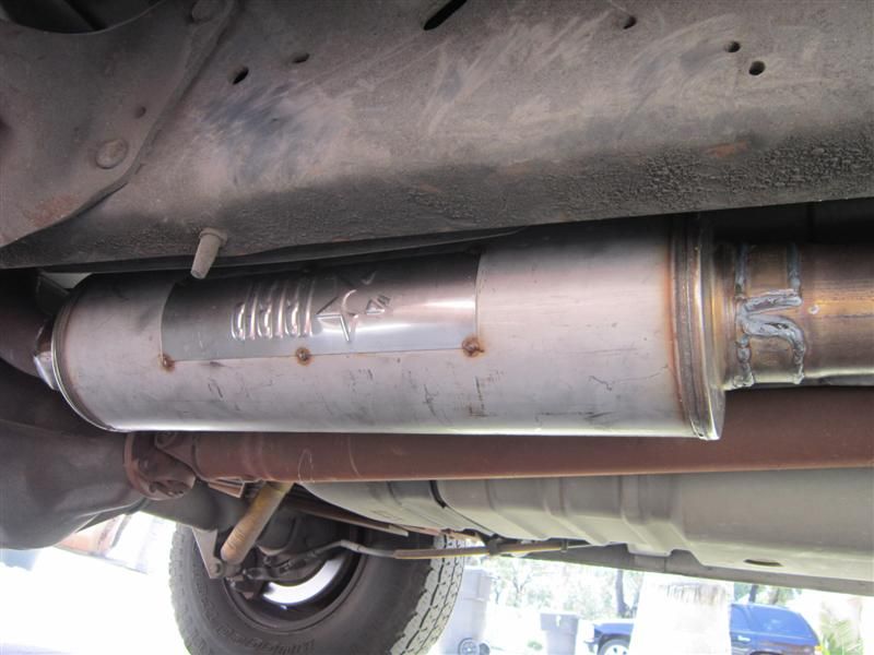

I kept my muffler from my diesel truck I had awhile back and put it to good use. It's an RBP stainless steel muffler, the V10 has a little deeper rumble now.

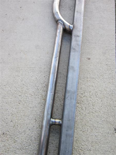

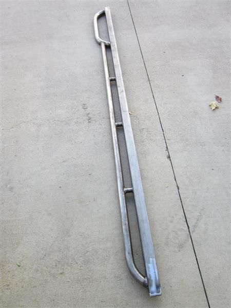

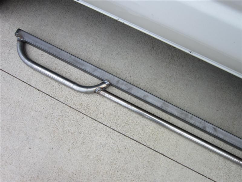

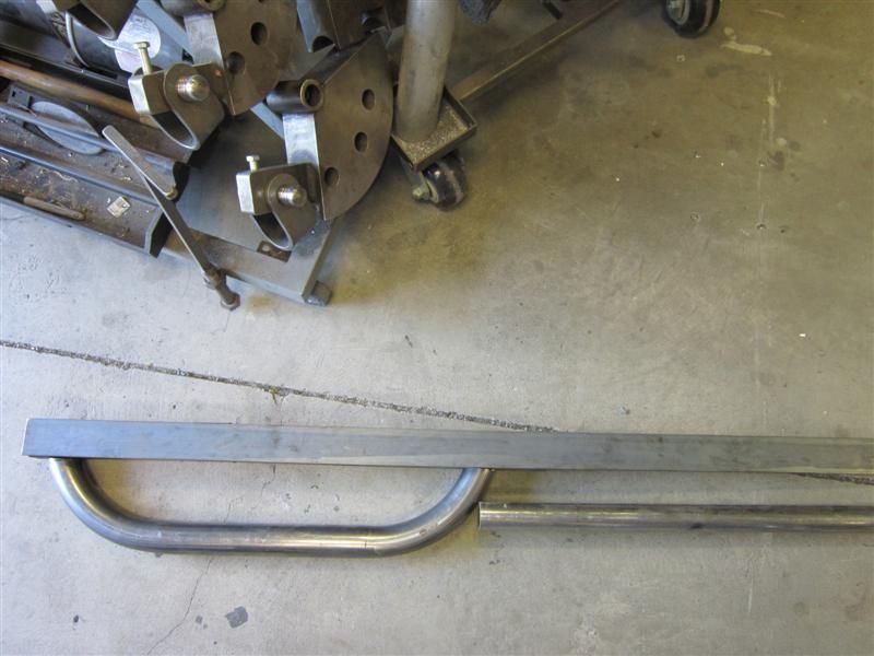

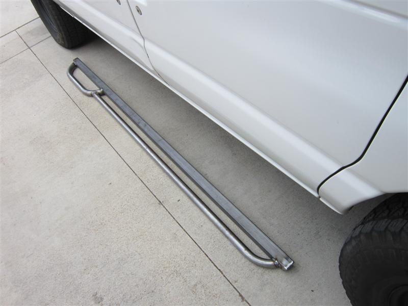

So here is a teaser shot of the rock/rub rails w/bump out I'm making. The bottom will be 2x2 square tube and the back bump out tube will be 1.75 and the front tube will be 1.5. This shot gives you the general idea of the design, the 1.5 will be notched to fit snugly onto the 1.75. I'll update as I go.
