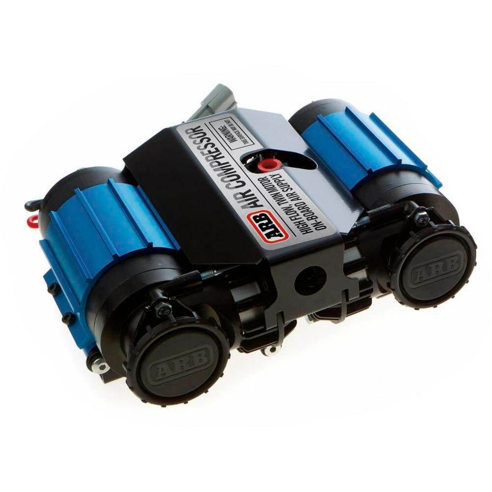

-ARB twin - clip on chuck- through core - 8 to 28psi - 210 seconds
-ARB twin - CRT chuck inflator - no core - 8 to 28psi - 160 seconds

-ARB Twin - LockNflate chuck - Through core - 8 to 28psi - 190 seconds

-ARB twin is the largest compressor from ARB and is mounted in my old Willys Jeep. with a small 1/2-3/4 gallon tank
This is rated at 6.16cfm free flow and 4.7cfm at 29psi
