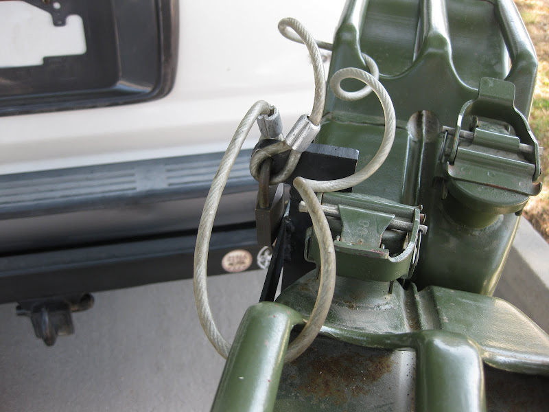

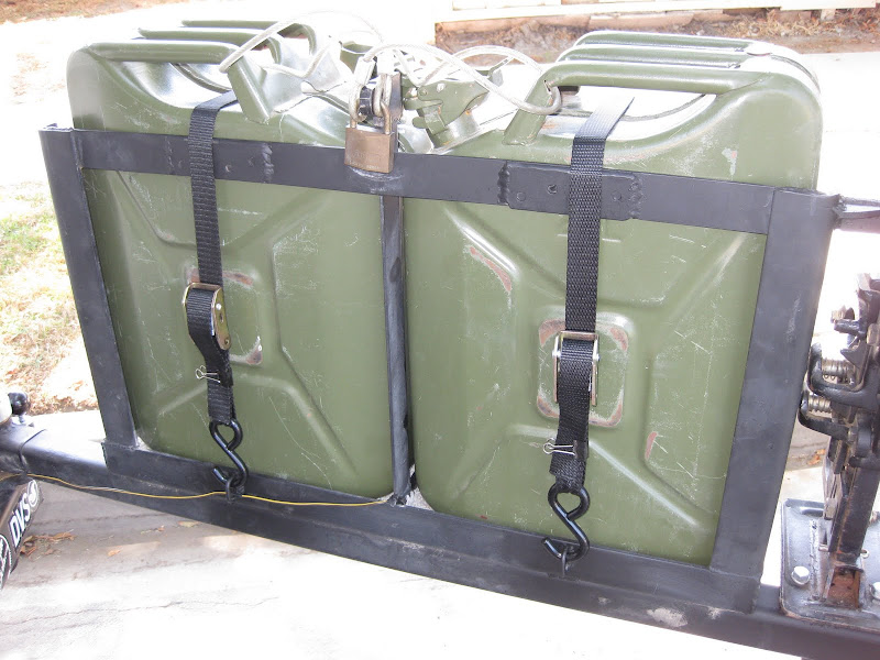

Made a few changes to the swing out. The blitz cans I was using were all rusted inside, breaking particles loose and one even developed a pin hole spraying gas out the back of the truck. To replace those, I picked up a nice pair of jerry cans from an expo member..a substantial improvement in every way :victory:!
The original design let the cans rattle around, so I went with the strap method. I'm very happy with how they turned out and it seems they will hold much better. The tab at the top still allows me to mount a lock and run a security cable through the can handles. I also added some carpet padding underneath the cans to absorb some shock, as well as create a nice little nest for when the cans are filled up.

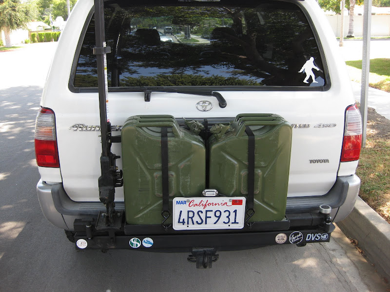

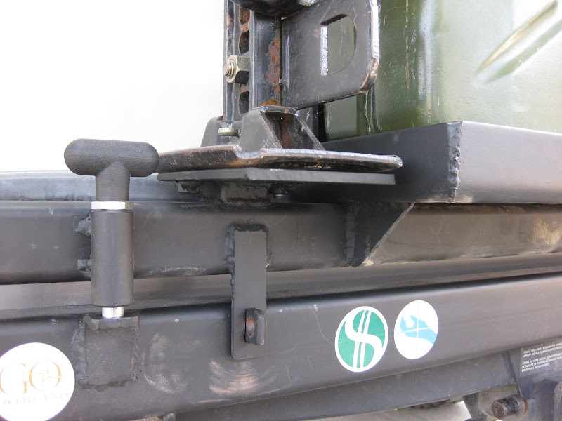

I also added a hi-lift mount to get it off of the roof, but am still up in the air about it. The base is very secure, with bolts going through the foot. The top is a little sketch, but doesn't seem like it's going to snap off.
I'm just wondering if all that vertical weight will cause something to fail in the swing out? There is a little play in the arm itself already, but there are three devices holding it closed (main pin, swing out pin, and lock)...What do you guys think? Yay or nay? Thanks for your input!

That bumper set up looks great. Not sure if you had one, I can't tell from the picture, but for a bushing to reduce metal/metal with the high-lift, I use an old shock bushing on the bolt through the upper mount. Just an idea.

I'm undecided on that part. I may sell it all outright to another 3rd gen owner, since there aren't many swing outs available to them. Otherwise, I will mount it in a double-shear configuration using a giant bolt to one of the corners of the bumper...Just have to see how I feel when the bumper is closer to completion.
Looking good man. Did you use scraps from my bumper for the hi-lift mount?
I had some left overs from other projects. I'm not going to run the hi-lift I decided. Even on the streets it vibrates a lot just hitting expansion joints and cracks. Not sure why I lug that thing around anyway..
