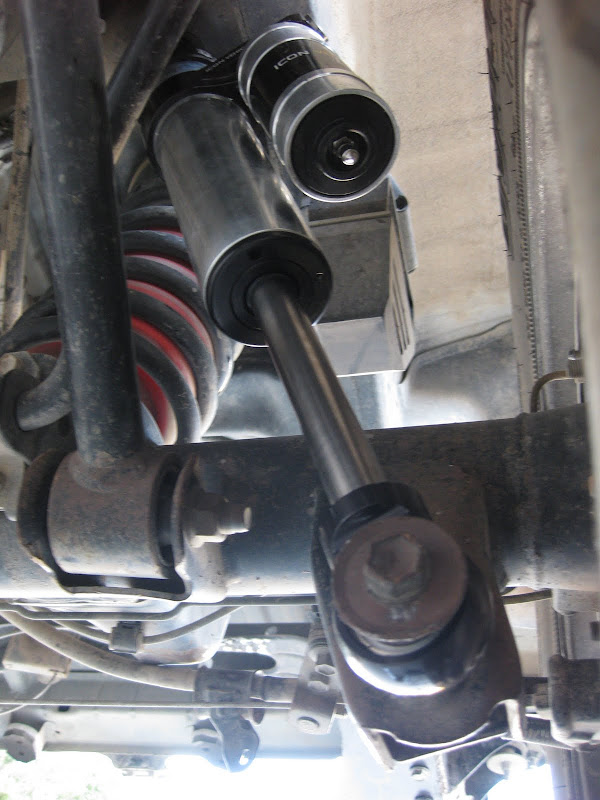

Those shocks look nice, what rear springs are you using with them? How is the street ride?
Thanks
OME 890's for now. I was concerned that with the extra weight of my new rear bumper that it would sag, but the rear end is pretty sky jacked without a bumper added.
Street ride is awesome, much better than the OME N86 comfort imo.
On a side note, I actually gained lift after installing these. Not sure if it will settle after they have broken in, but the rear is noticeably higher than before.
As you've probably figured out, the bit of lift you got is from the pressure inside the shock pushing the shock rod out (same effect as an air shock) - this force on the shock rod is helping support just a little of the rear weight. If the rear does settle a bit it'll be either the rear springs settling or slight loss of shock pressure.
Those are pretty pimp looking shocks. Do you have any noticable increase in bump/road noise being transfered from the heims on the axle end of the shock?
I emailed Icon to see what spring they recommended and didn't get a response..yet. The 890's do sag when loaded up with gear you're right. As a band-aid, I usually inflate my airbags at the beginning of a trip, but that's not always so useful when you finally get in the dirt. I would be interested to find a custom spring that works well, I don't know if LC springs would fit the bill as a good match.
The ride in the rear is sort of comparable to when you switched out your front suspension to coilovers. Stiffer but more controlled. I really can't push down the rear of the runner all that well, which would indicate the shock pressure like corax mentioned.
I've noticed no noise in the rear, but then again they are brand new. If that does start, i'm sure their ability to be rebuilt will make those heims replaceable in the future.

Today is a good day in the world of 3rd Gen rear suspension. I installed Icon's newly released rear piggy back reservoir shocks on the 4Runner this evening. Initial impressions are very strong:victory:. The quality looks right up there with their coilovers and these things are stout!
With the same shock body diameter as my front DR's, they are a perfect match for the rear. The little street driving i've done this evening shows vast improvements when going through dips. Before, I'd feel the rear compress easily for that spine shattering jolt; now it's much more controlled and dampens just as it's intended.
The install was a little trickier than I had anticipated. The rebound is so strong I couldn't compress them by hand and had to use a hi-lift to lift the truck from the rear bumper to gain clearance, as well as use a floor jack to compress the shock. A C-clamp is then used to bring the bottom of the shock over the lower shock mount. 4 spacers are also included in the box, they are installed on either side of the shock bottom.
New dampeners are slightly longer than the OME N86C shocks for a little more travel.

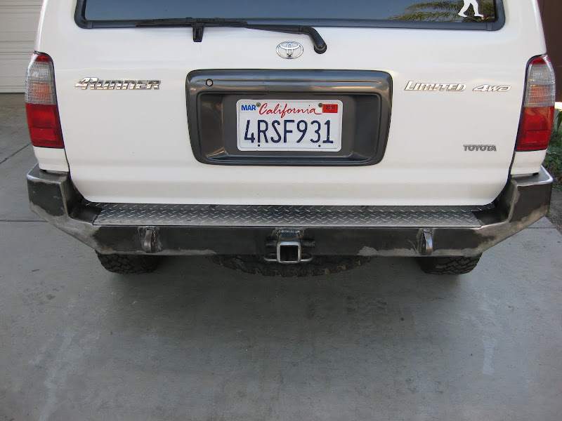

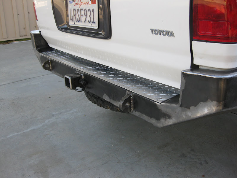

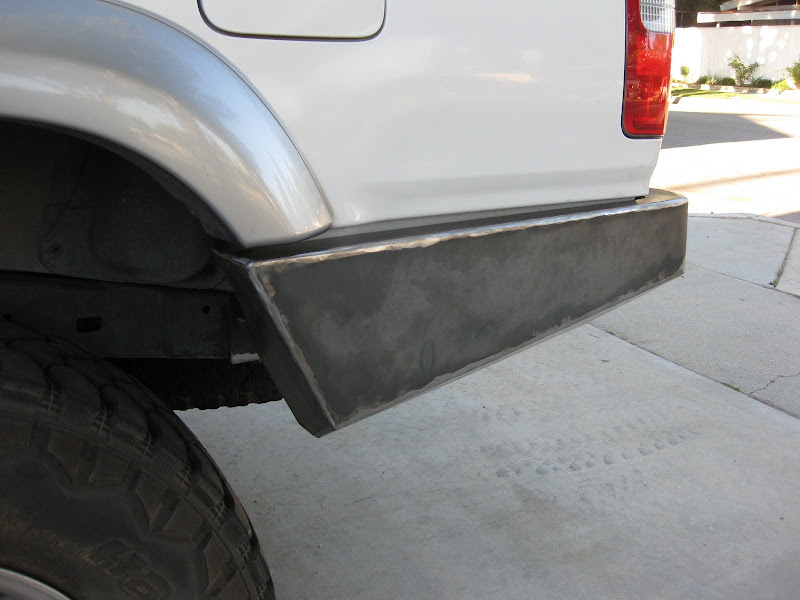

Nearing the end of my rear bumper build, just thought i'd throw up a few pics before powder coating tomorrow. It's a BruceTS styled bumper with a few tweaks of my own. The main differences being weld-through clevis mounts and an alternative to reusing the stock faded plastic bumper top.
Hay Heavy is that ?
Great work , solid steel , can handle all most anything
Hay you attach to the frame , weld or flex ?
I love that bumper style !:victory:
The bumper is bolted on in the stock tow hitch locations as well as over the frame. I'll get the weight before I put it on for the final time, it takes two people to put on though.
