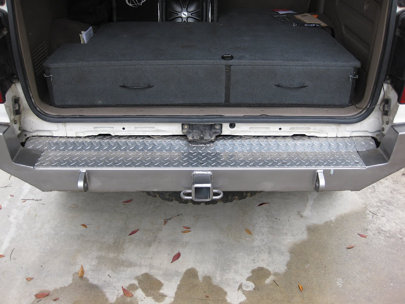

I would love to see more build pics of the bumper. Very nice. Did you do any frame strengthening?

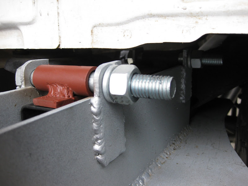

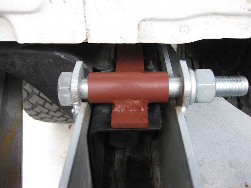

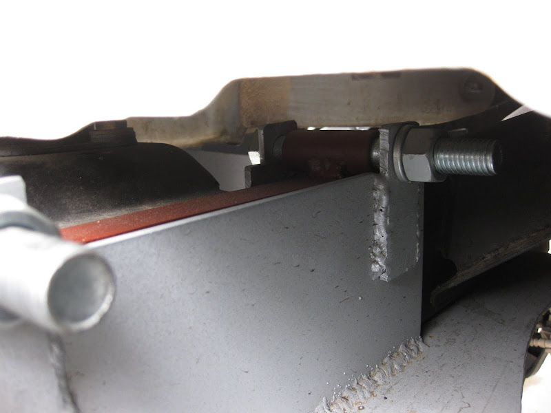

As requested, pics of the upper frame reinforcement:
The metal strap running back can be made wider, I was just working with a piece of scrap that I had to divide to make both sides. It acts more as a spacer anyway.

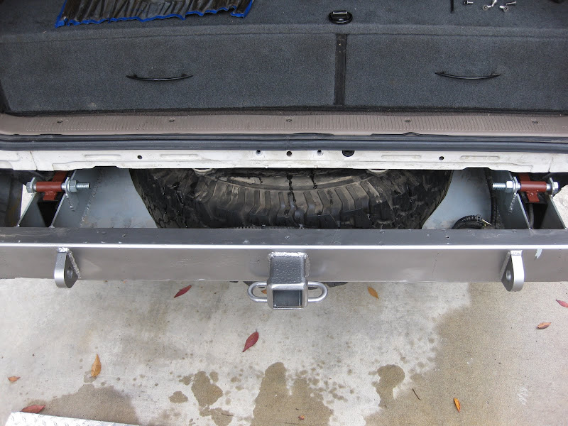

Parallel black tube running across is the air line for the airbags.

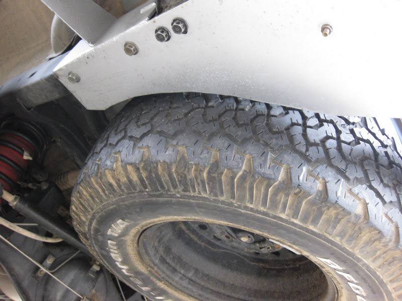

Cut out for 265/75/16 Spare, and (4) factory tow hitch bolt locations. Airbag fill nipple also pictured.
Duct tape rash guard as noted by red87. Still holding well for the time being, and a surprising color match ;).
Nice job on the bumper. But I do worry about the air bag fill valve being that far back. I have hit my back bumper in that location a few times.
