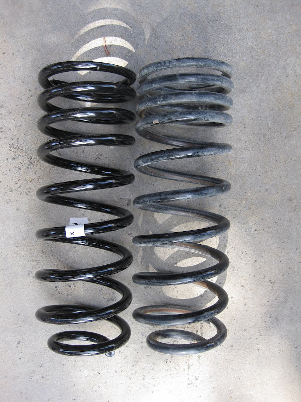

My OME 890 rear springs were starting to show their lack of support in some of the bigger dips offroad, so I decided to make the move to the OME 891 springs, rated +600 lbs.
I also ditched the airbags, one sprang a leak. A replacement bag is $40, and a whole new system is $80. If I need the support in the future, i'll just start fresh.
Removing the 10mm trim packer and just leaving the stock bump cone netted the same amount of lift after the switch.
The 891 (left) coil is 1mm thicker than the 890 (right). Also note the spacing of the top coils. When installed, the 890 upper few coils actually touched at rest, all of the powder coat was rubbed off between these wraps.
Install took about an hour, 45 minutes, mostly due to some ratchet strapping to compress the springs.
