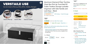

So here's another option: I'm looking at replacing the cheap battery box on the tongue (which currently has 2 x 12v Group 24 FLA batteries) with something like this:
There will likely be enough extra room in the box that I could put in some insulation. Do you think that would keep the batteries sufficiently warm that they wouldn't get damaged by cold weather? Once the trip is over and we're back home I have the option of taking the batteries inside the garage.

It's just that I think the insides of that steel box will lose heat faster if it is exposed to wind. Wind chill was my bad example. The OP need not worry of anything that extreme.
At least that has been my experience, with water in tanks starting to freeze up - exposed vs sheltered. But that might have been my bad luck.
Wind will cause whatever it is to lose heat faster than without wind so the time to cool will be faster and the time to heat will be longer. It’s still a valid concern.
Well wind will replace warmer air with colder air, but it will not change the temperature. Nothing will get colder than the air temp.
That’s basically what I said. The batteries (and their housing if applicable) will cool faster with the added convective cooling caused by the presence of wind rather than just conductive and radiated cooling in a no wind situation.
