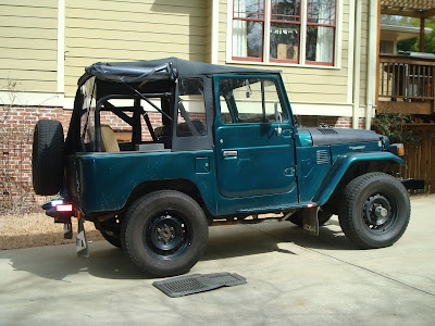

Here is my little toy 1979 BJ40 with B engine / 4speed. It came from Costa Rica with drums on all 4 and no roll bar. It did have the vent windows on the doors.
1911
Out of curiousity what would be a ballpark value for this truck? I want one.
Too many variables of condition and mileage, it all depends on the specific truck - but since they all have to be imported into the U.S., more than an FJ40 for sure. A really nice one would be a lot more. For reference, you can get a pretty nice FJ for $10-12,000 these days. There was a nice BJ Troopy for sale in CA last summer for $18,000 IIRC.
