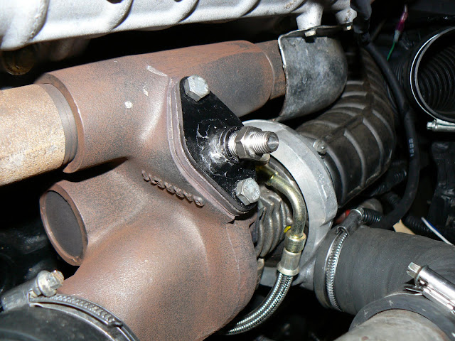

From the EE bbs:
http://www2.expeditionexchange.com/forums/showpost.php?p=27114&postcount=541
JSQ said:
Most importantly I installed the pyrometer for my EGT. I finally have an idea of how hot the turbo is getting and what kind of room I have to make fuel and boost adjustments.
I decided to use the EGR blanking plate as the location to weld a bung for the probe. This gives me a temp reading upstream of the turbo, right off the manifold and it gives an average temp across all four exhaust ports.
I drilled an angled hole through the plate and then ground a 45 degree surface on the back of the bung. That way the probe is cleanly in the center of the manifold.
Here's the probe:
And here it is installed:
It's working properly and I'm watching the behavior of the exhaust gas temp closely. So far so good it's well below any dangerous peak. I've read that 1200 degrees or so is the edge of the danger zone. I'd like to tune the turbo to produce what I can while staying well short of that.
The other nice thing about having EGT is I now have a gauge to show me when the turbo is sufficiently cool to shut down the motor. Up until now after driving any considerable distance I would idle the motor after parking to allow the turbo to cool and prevent excessive wear. This was really just a guessing game though. 30 seconds or a minute and I turned it off. Now I just watch the gauge and let it get down to 450 before I kill the engine.
It's a very good feeling to have these accurate gauges and senders in and know what's really going on with the 300Tdi.

1200 is not dangerous. You can run continuously there forever. Short term limits are much higher. You don't need to add safety factors on top of this.
