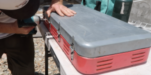

I decided to continue using our 2 burner camp stove. It's a bit tattered but the burners still work fine, so I replaced the rusted apart hinges with some random ones I had around the shop and cleaned it up real good.

I didn't want to use space in my drawers to stow the stove, so I rigged up a tab on each side of the stove and glassed threaded inserts into the countertop. Now I can hold the stove in place with a couple of thumb screws while driving. I also got a silicone mat to go under the stove, so it wouldn't scuff up the counter. This should make camp setup/break down a little faster too.
