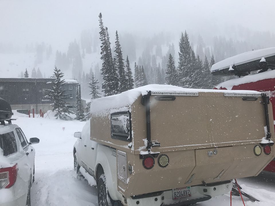

Few thoughts from the above posts I'll echo having built a hard-side slide-up:
1) Slide-ups are complicated (i.e., a PITA to build for most of us)! Once it's working smoothly though, it is a very robust and weatherproof design.
2) Loss of storage is a real issue (applies to all pop-up types though)
3) You do get the full width sleeping if your bed is at the level of the slide-up - my mattress is 72" (inside width of lower part of the camper) but I get the 76" wall to wall width of the slide-up portion where I am when in the bed.
Few thoughts from my experience camping in a pop-up (in all types of weather):
1) Unless the hard sides on the pop-up are well insulated, I don't see a huge advantage vs. a soft-sided pop-up of some sort that uses waterproof fabric and has some insulation (either built in to the fabric or an add-on when needed). I now camp in all temps and weather conditions with the soft sides on mine up.
2) For me, any design that lets in moisture (or bugs!) when setting up or taking down is a step down from a good soft-side
There is an undeniable cool factor with many of these hard-sided pop-ups and some super clever designs - I see their appeal for sure. No regrets on my design but it does have trade-offs (like all rigs).
