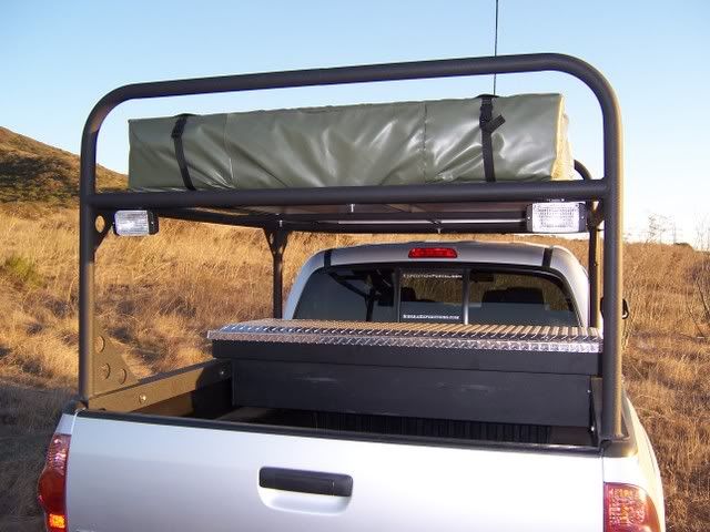

Hi TacoDoc,
I've been reading this thread with great interest, and congrats on building one hell of an expedition vehicle!
I was wondering if your roof rack was built above the clearance of your toolbox when it is fully opened, or if the lid of the toolbox touches the rack when you open it. I'm trying to customize an expedition rack, but I don't want to put it too high above the roof, as I'm trying to streamline everything as much as possible.

Thanks and welcome to ExPo!
The box hits the rack when fully open, it's opening radius is probably reduced by 1 inch. My rack height was determined by the Eezi-Awn 1600's dimensions, I could have gone lower with the rack witha 1400 but someone would have been sleeping elsewhere... we needed the sleeping room.

Thanks! Great ideas on the rack height. I definitely need to get these issues sorted-out before Spring/Summer comes around and I'm back in the field.
You mentioned that you had to go higher with the rack to accommodate the size of the 1600 model - is this because its width when open is 63 inches, which is a quarter-foot longer than the 5-foot DC bed?
Here are some pics to illustrate the toolbox lid and rack clearance.

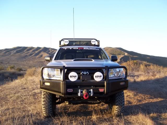

Rack Lights and Antenna Mounts!
I started adding things to the rack, another set of IPF 969's and got my CB antenna mounted with a quick disconnect from Firestik, I have one more tab there in the middle for a future 2M antenna...
Back Up Lighting
I like to have good visibility at night when backing up, these PM brand 55W utility lights that I found at Wally World for $12 ea should work. I am really liking the fact that rearward visibility has been maintained with this rack system.
snowbrock said:
yes, how much longer is the 1600 than the tacoma short bed?
This first pic illustrates how the length of the 1600 necessitated the lengthening of the rack to accommodate it, and how I have the Engel and Eezi-Awn facing the same direction. A 1400 would have been a perfect fit but was too small for our needs.
