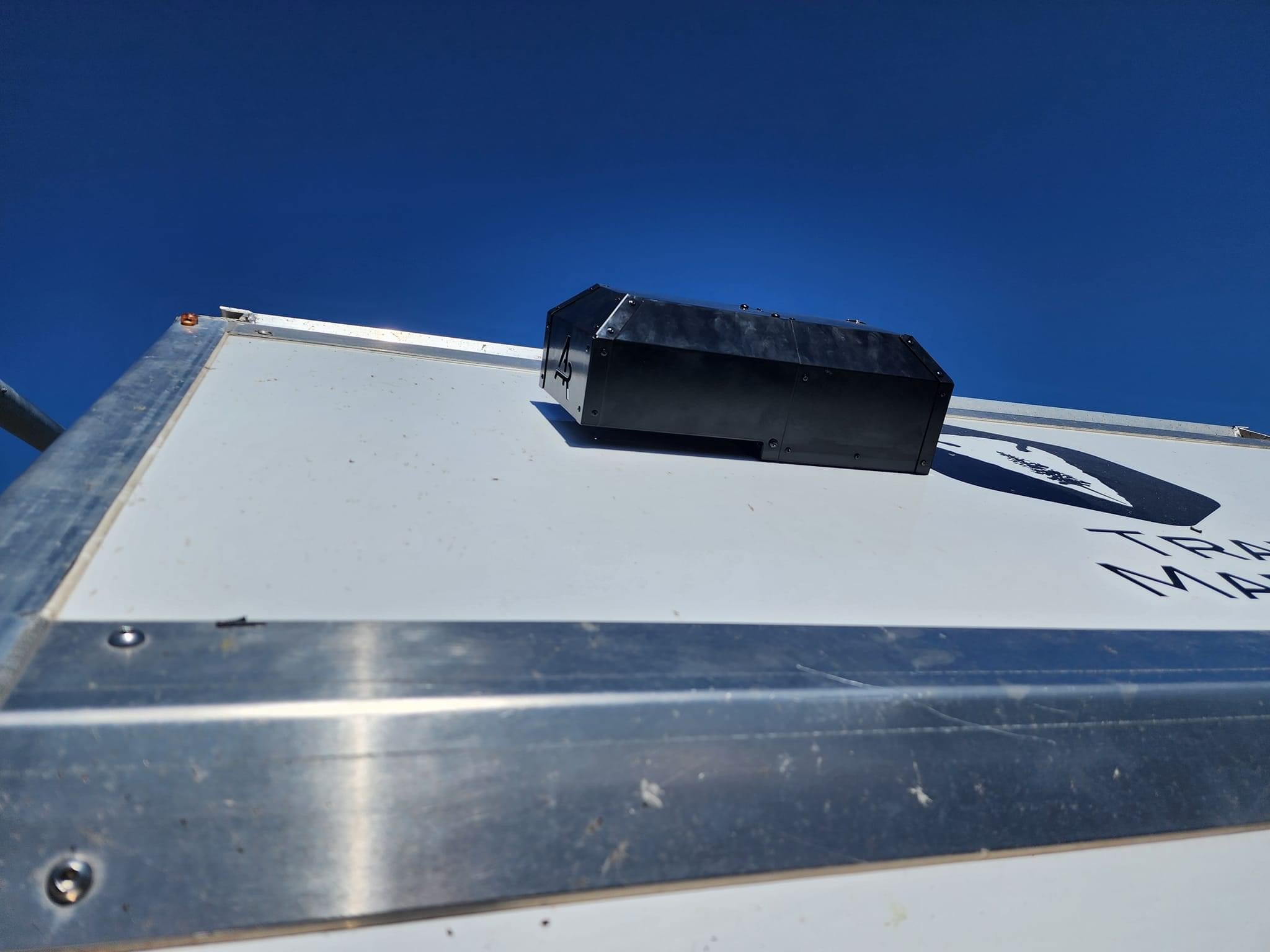

We've developed a positive pressure system, called DustBox.
After building our own overland trailer, we've found that in desert or on extended bumpy gravel roads pesky dust/silt etc. get into various spaces, even with use of good/tight seals, Tern Overland's windows, etc.
I'm assuming I'm not the only one who loves to take those back roads, but hates the thought of "how much dust" I would be dealing with on the interior compartments, bedding or kitchen slide once I arrive at the destination.
Well, after almost a year of research, going through various setups, fan models, designs - my buddy engineer and I who does all the fab work & assembly - came up with DustBox.
DustBox is a positive pressure system (other names used in the industries - overpressure system / dust reduction system / dust mitigation system / dust control system, etc.),
It pressurized cabin space onto which its installed and maintains the pressure to keep dust out.
So far, largest test been done on a 23ft RV camper trailer. Has proven to do the job. Our trailer is a 5x10ft with 5ft walls.
System builds enough pressure to where I'm not able to shut the clam of the roof section while its running.
Potential use is varied, trailers, truck canopies, campers, etc., something to keep in mind that space has to be fairly sealed, as any large opening will not allow the system to pressurize the cab.

Great information and thank you. I must say I had an issue with my propex heater throwing a code that it interference with exhaust and or intake. My portable vac did the trick of clearing it. I am convinced it was dust. I think I am going to buy one of these units for this reason and a much cleaner trailer. The finer the dust the more likely to breath it in.
How does it filter the air that it's pumping into the trailer?
Cone style washable/reusable automotive filter similar to K&N
Low profile version and an RV drop in units will have MERV rated filters, that are washable, like the cone one on the original unit (V1)
Low profile version (v2) uses Merv6 rated filter and its under 3in from the mount surface, but will require a larger opening.
Attached pictures on a stand that I use in our show booth.
Stand has1.5in wall thickness, thus you'll find the inner section about 3 inches inset, opening is around 8.5x8.5in

Update on install. So full disclosure I am mechanically impotent so did not even consider doing the install myself.
I did however get out the caulk gun and closed all the window shades. Then turned on all the interior lights. Then in the pitch dark garage looked for light shining through. Found a few spots that needed silicone caulk. She is sealed up pretty tight.
Dropped trailer with the DustBox, wiring harness, permatex sealant/adhesive and adjustable swithbox at my installers shop. We discussed placement and wiring procedures. Decided best to run wires internally inside trailer then into tounge box. To be continued...
