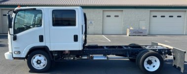

with one vehicle https://www.proxibid.com/2021-CHEVROLET-4500-COE-CREW-CAB-CAB-CHASSIS/lotInformation/85888876
