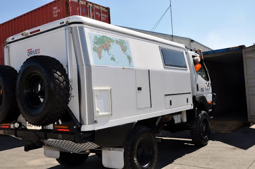

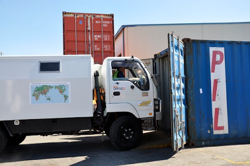

Thus on the 30th April, we loaded our vehicle ‘Goanna’ together with 3 other vehicles into 2 x 40’ containers bound for Kuala Lumpa. From here I have coordinated the travel of the group through Malaysia, Thailand, Cambodia, Laos, China, Tibet, Mongolia, and on the Vladivostok. The vehicles will then be shipped to Long Beach California for our eventual expedition from Alaska to South America during 2011/2012.
The vehicles are 2 x EarthCruisers, 1 x our previous Canter and 1 x Isuzu NPS

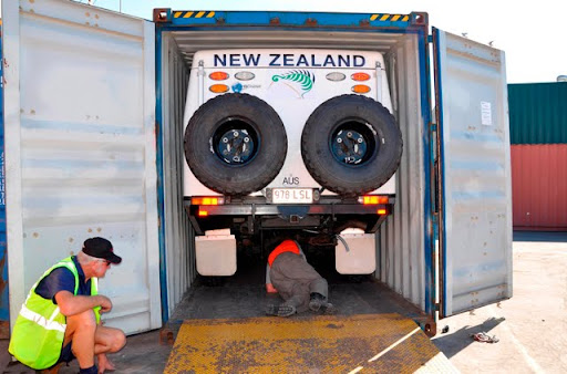

It looks tight buy you can exit the cab via the drivers window and climb down between the bull bar and the container. After lashing down the front you can exit under the rear differential.
