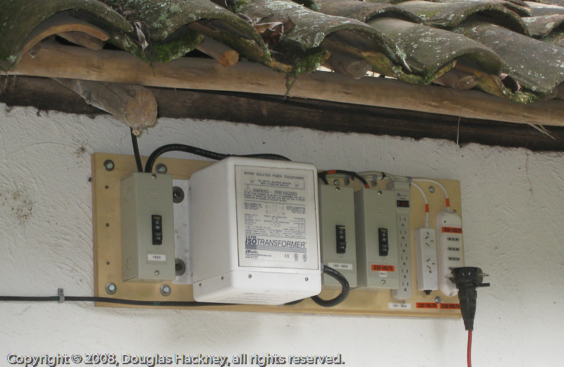

* Along the same lines, even if you've started wiring or procured your appliances, build this vehicle for 220VAC/50-60Hz. Unless you are in Japan or between the arctic circle and Ecuador, you will be living in a 220V world. Need a new tea kettle or toaster? Prepare for the usual 2-3 week customs dance unless you're on 220.
220v appliances are available through marine suppliers. I'm assuming you are using a marine AC/DC distribution panel and they are all 220V compatible. If you've procured 110v appliances then return them or sell them and install 220. You will, inevitably, need to interface to the outside electrical grid for a variety of reasons in a variety of scenarios. While a 220V/50-60Hz battery charger will keep your house bank charged, the ability to easily interchange and interconnect your internal AC electrical world with the outside world will make your life very much easier. At this point you probably are dreaming of multiple years completely off the grid, camped in remote places, far away from civilization. In reality, you will spend a lot of time in and around civilization, especially if you find a community you very much enjoy and want to stay for a few weeks or months to really get to understand the culture and people. Those people will be on 220VAC. The ability to plug in will make your life a lot easier. You don't want to annoy those new friends running your genset. And that's just the beginning of the reasons why...
* There is only one grounded circuit that I know of in South America. It's grounded because I built it (Otavalo, Ecuador). This is probably true of most of the rest of the developing world. Consequently, all those times you will want to plug in to avoid offending the neighbors with your genset, you'll want to be grounded. Go to Lowes or Home Depot and buy a one meter copper ground rod and a corresponding cable clamp. Get two or three meters of heavy gauge stranded cable. Create a grounding lug on your chassis. You'll already be carrying a 2lb. hammer to drive the rod. Test this setup and connection while you're in North America. It's quick, easy and could save the life of one or more of your family.
* If you stay with 110VAC/60HZ systems, note that a stepdown transformer (220-->110) only changes the voltage, not the frequency. Read the data plates on EVERYTHING you may plug into your 110V system while you are running on externally provided AC. Make sure each device is capable of operating on 50Hz (frequency) AC power. Charles Marine makes excellent 220/110 isolation transformers like this one we left at the campground in Otavalo.
