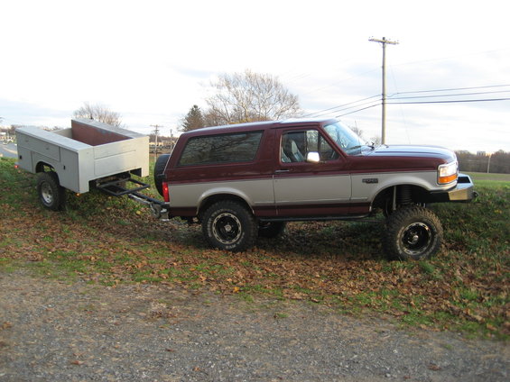

The tow vehicle:
The trailer as it stands today:

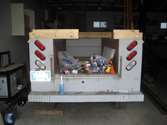

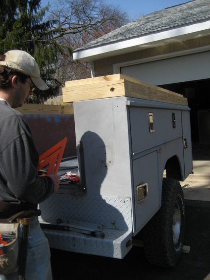

- Got the rear lights mounted
- Got the main frame cut and temporarily mounted. I'll still need to pull it up for the roll on bed coating and for fit where the door will be
- Got the old, non-functional latches out and the new ones mocked into place

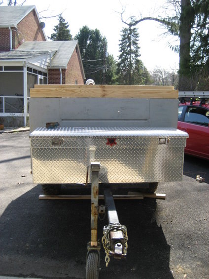

- Got the tongue box set and drilled (still need to tap the holes and find a rubber isolators.
- Started cutting the frame for the rear tail gate/porch :eek:)
- Bought most of the alum. for running along the wood seams, and steel for building the frame out for the rear jacks, rear tow hitch, and lid support for when it's opened. This weekend I'll have to head back to get a little more steel to make a Grill mount and some other misc. angle for bracing
- Got a bunch of other misc. parts, like new hubs for the 5 on 5.5inch spacing to match the bronco's wheels, stainless piano hinge and some interior push button lights
This weekend between family stuff, I'm going to start setting up and cutting the top. I ordered a Kraig pocket jig set for the attachment of the roof spars, so I'll have to practice with that a bit to make sure I don't screw anything up (bad pun, I know).
