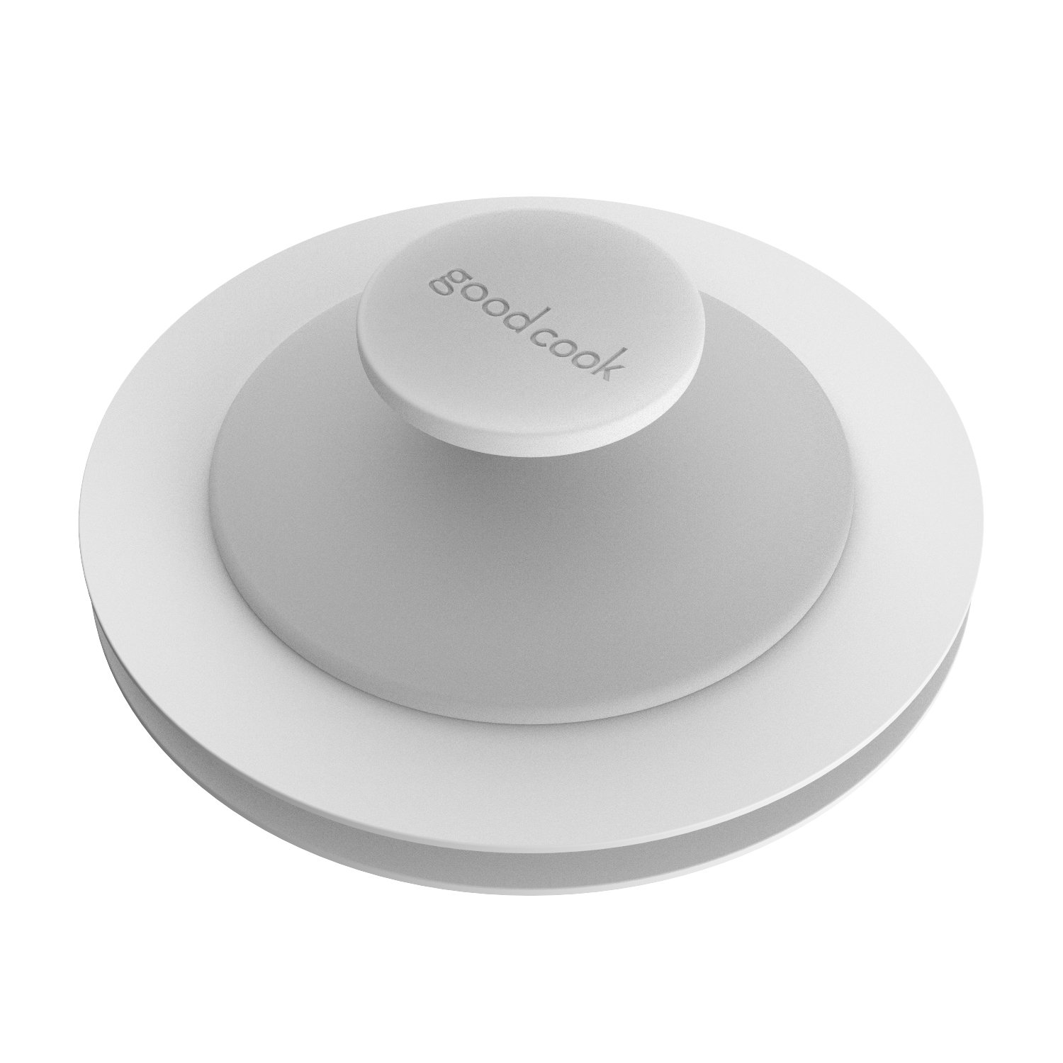

Things I have to add or change:
- quick release mounts for ladders
- lighter holster inside kitchen box for quick access
- better sink plug. sand and dirt are drifting up into the sink on the dirt roads
