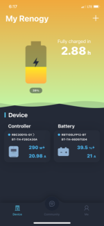

Finally got around to adding a 'house' battery setup in the back. The OE 2nd row console was missing trim when I bought the car, and it ended up being a great place to sneak a Group 31 100Ah lithium battery on the floor. I used a bunch of stuff from Renogy, since they seem to make great product and a lot of friends have had good luck with them. I made the false floor early on, since we won't be using the 3rd row and I wanted more functionality out of the rear. Everything is removable easily either way, and I tapped into the existing 30a power supply to the rear 3rd row since that's already on a factory fuse and designed to carry a good current load. Pretty sweet that it's all setup via Bluetooth so I can monitor charge status and temperatures. I'll eventually add a solar connection plug, but for now this should suffice.
