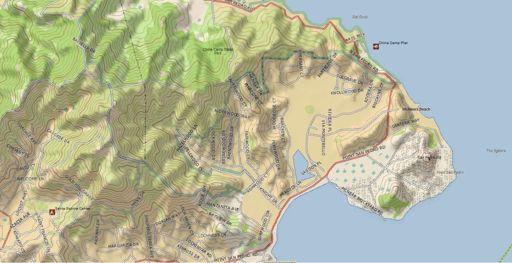

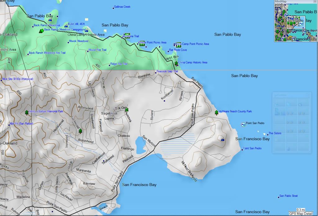

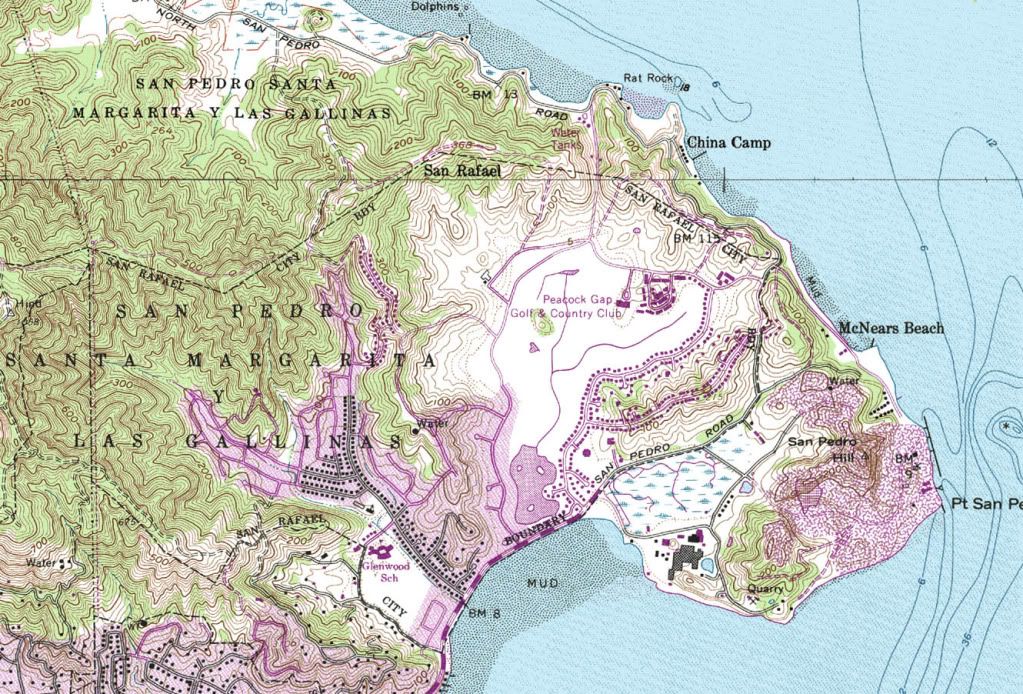

Here's a visual to show you the difference between the DeLorme, Garmin, and USGS 1:24,000 topo maps of the same area. (Disclaimer: I did not create these pictures and take no credit for them; I copied them from this thread in the DeLorme forums: http://forum.delorme.com/viewtopic.php?t=16085#p87970)
Garmin Mapsource
DeLorme Topo USA 7 (version 8 is now the current version)
USGS 1:24,000
For me personally, there's nothing I'd be realistically doing where the DeLorme maps just wouldn't cut it. Again, keep in mind, the streets you see in those maps are up to date and are routable just like in typical street mapping software. Now, for the best of both worlds, you can pay for the $30/year subscription from DeLorme, download the USGS 1:24,000 maps, and create a hybrid view with the base topo/street maps:

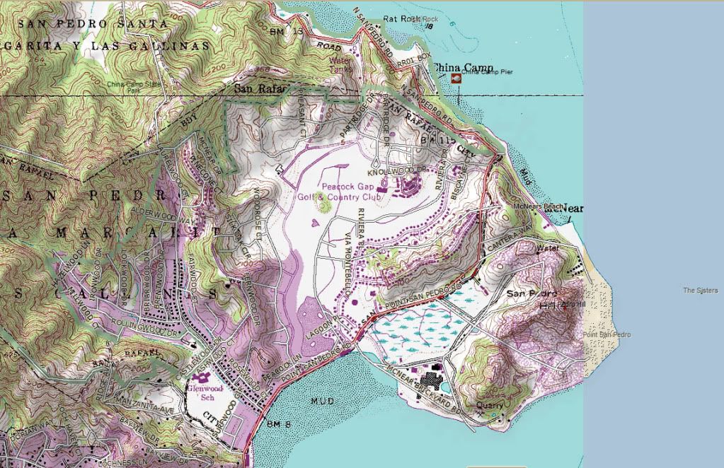

DeLorme Topo 7 w/ USGS 1:24,000 Overlay
