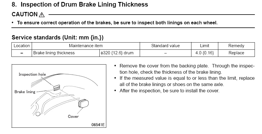

The relevent pages of the service manual for the brake system for current model Fusos is here: http://www.hackneys.com/mitsu/docs/fuso-brakes.pdf
The spec you are looking for is:
Doug
Thanks guys...
No problems with the brakes, I am just doing the before trip maintenance checks.
I did check the inspection holes and the lining looked thick enough but the info in Doug's message confirms it.
